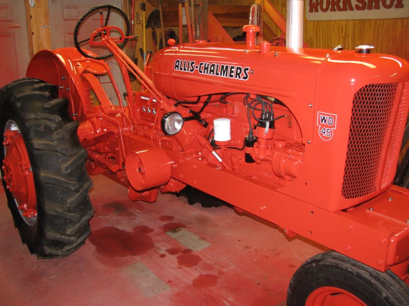

Stan, that 45 is SWEEEEETTT!!!  NICE job on it!!  How many HOURS do you have in it?
Thanks!  Well I don't know the hours but my life was not my own for 18 months and that included every weekend and I would work an hour or two each night after work.  I have to admit I was sick of working on it by the time I was done.  And at some point I need to install a Reddy-sleeve on the front of the crankshaft as I can't get that darn seal to quit leaking and I've replaced the seal twice already.Unhappy

Maybe they're makin' em' a little better now, but man, the ones I had were lumpy and bumpy. The WF's fenders are beyond repair also, that's why I'm installing a set of OEM WC fenders. Even the inner fender reinforcements are bad. Stan the man, that 45' is sweeeet brother!  Wow!  Lookin' good!!
