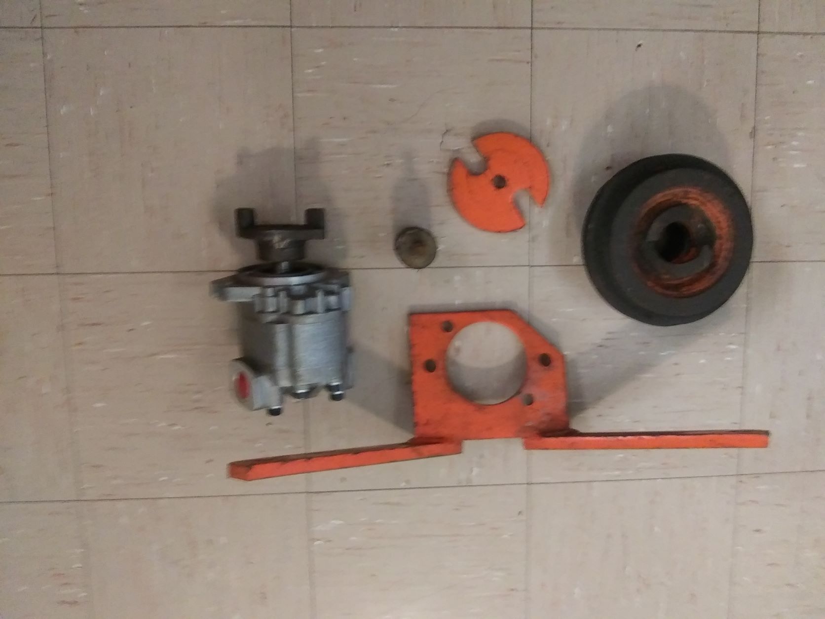

Dr Allis how was the pump mounted? Was it underneath with a belt or did it go through the frontend block and mount out front? Dad talked about someone that had one but I never seen one. Tom

There have been pics put on this website. The pump sat directly under the radiator and was driven by the crankshaft direct. No belt. The hand crank feature was removed to make room for the hydraulic pump.

Tom this is the parts that is used to install the front pump
