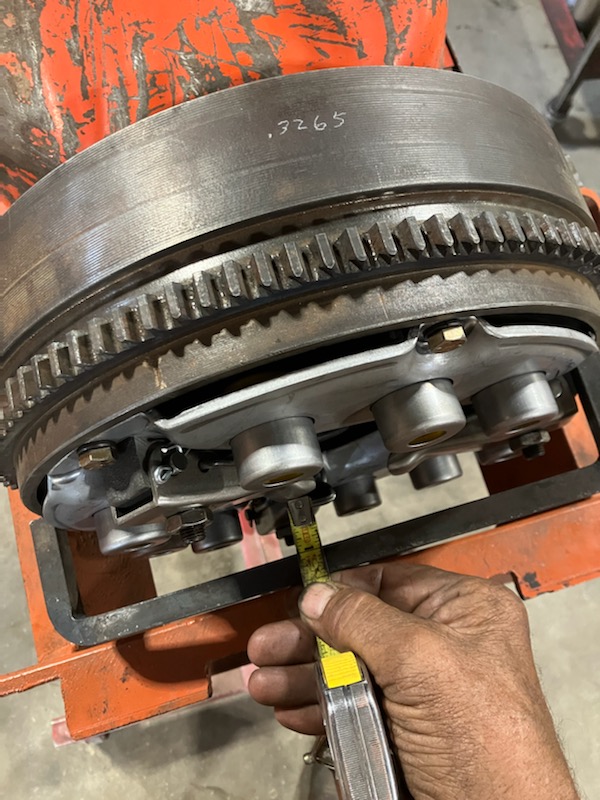

i just put a agco four pad disc in my wc puller ,  i think its thinner than a fiber disc it measures .326 thickness   new nine spring preasure plate but it almost tightened down before it grabbed the disc   step in wheel is 1.188.    how high and where do imeasure from to set  the finger hieght
