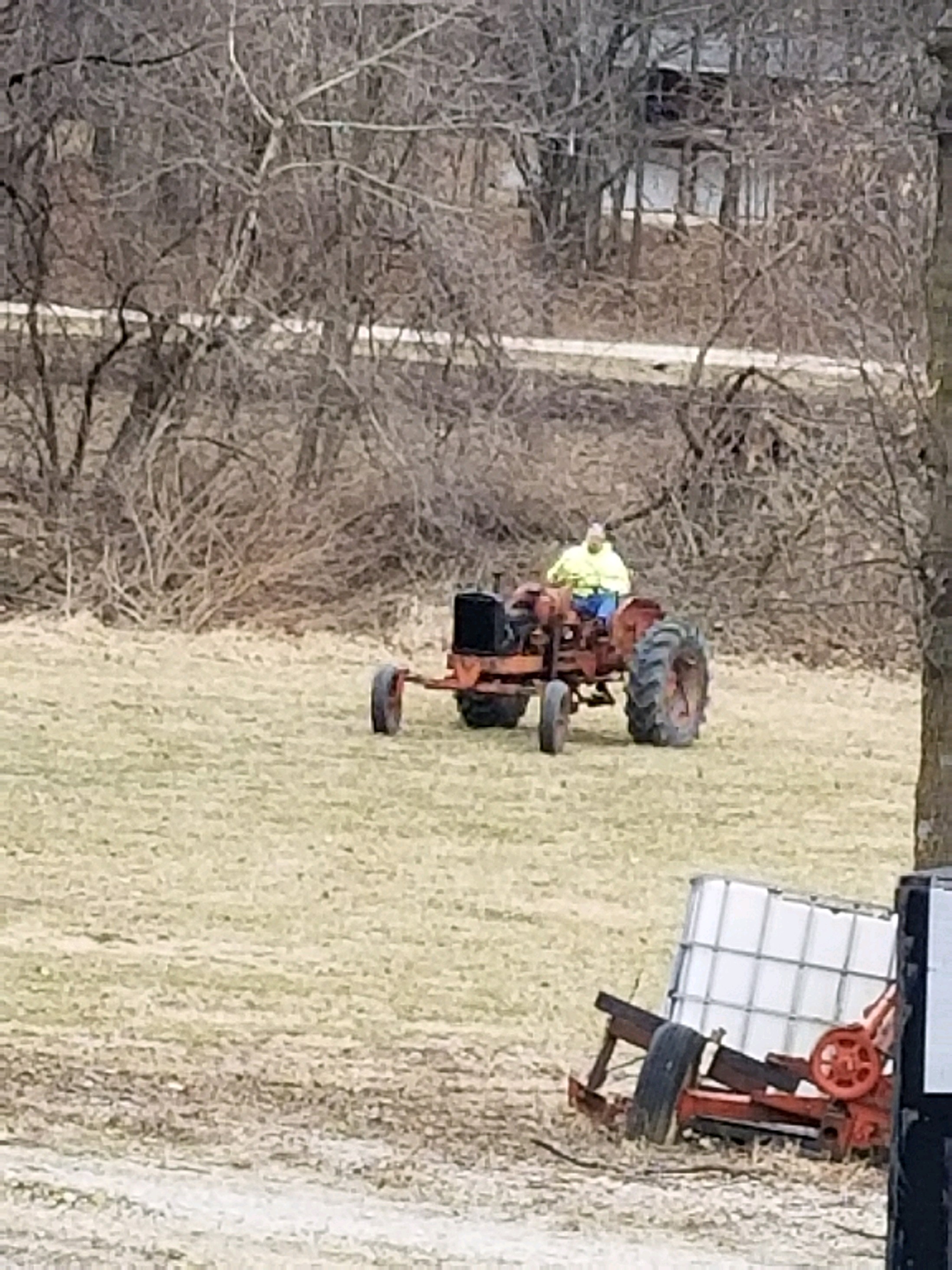

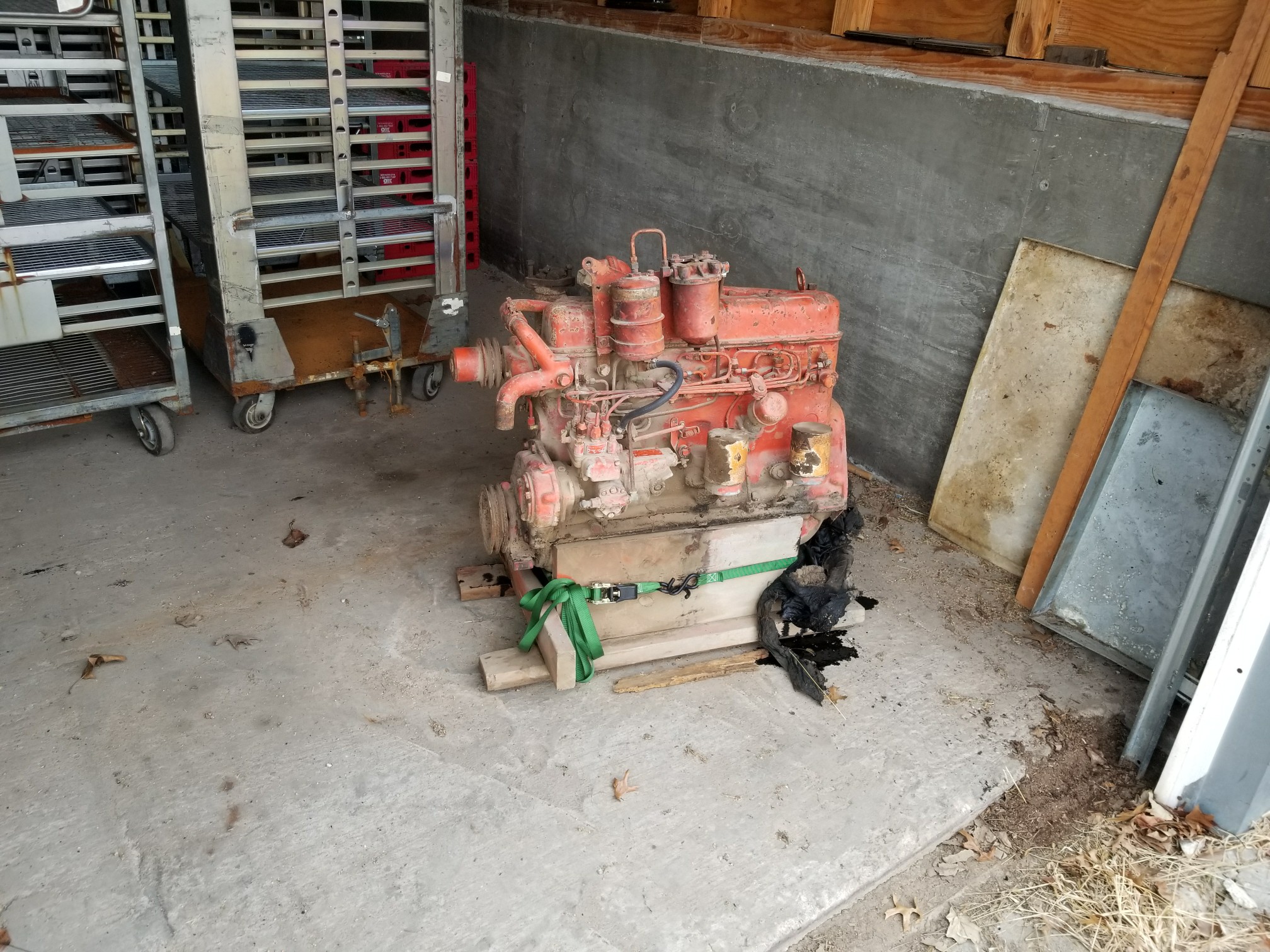

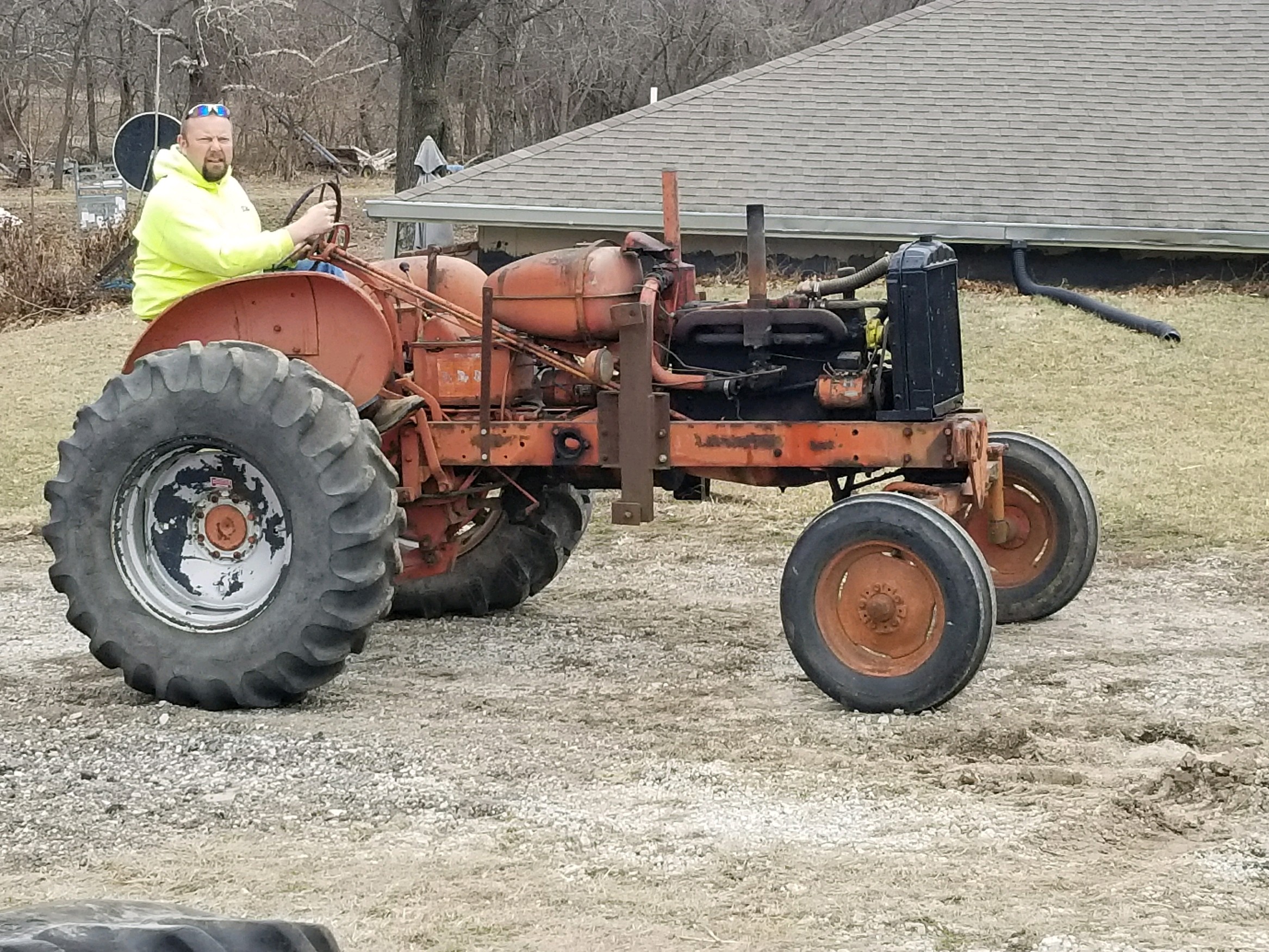

Put a coil, gas, tire and wheel,and a hot battery in started and drove the tractor today. Donor engine put in the shed. Dad and I came up with a plan to see if we can fix this issue of liner drop and blocks cracking in the 230 diesel engine.

The gas engine will probably stay in it for awhile till I build the diesel. I might make a WD 65 out of it for awhile that way I can pull a plow in roadgear.
