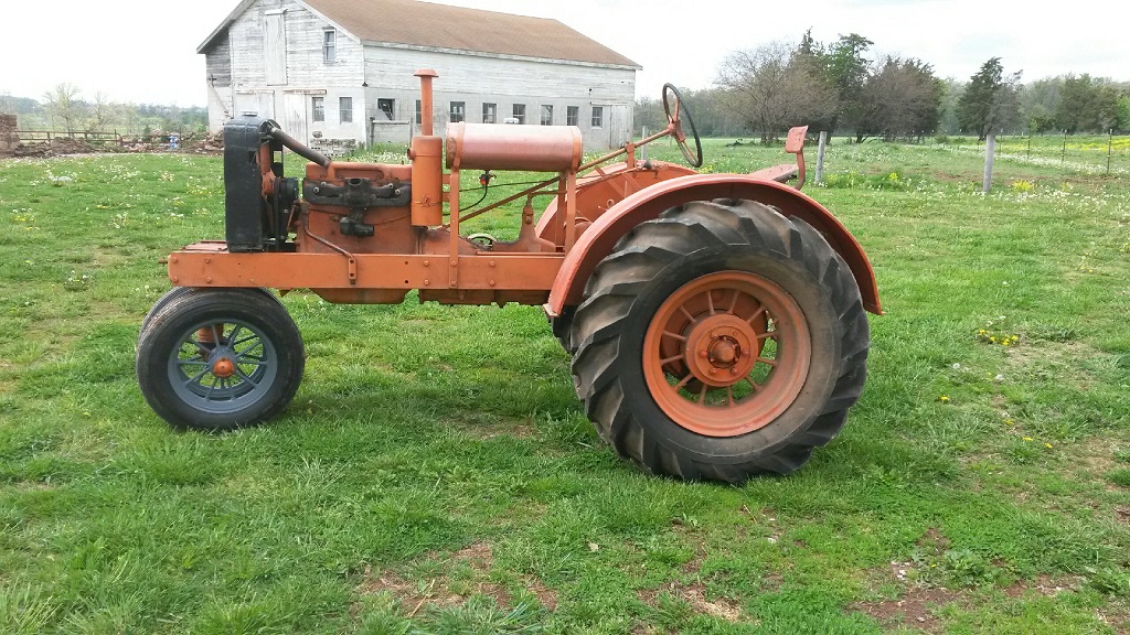

I recently bought a WC wide front end and was thinking about putting it on my 35 unstyled WC. My question is did all of the Wc's come with the wide front option or just the styled? And will my 17 Inch front rims work on the wide front? I do not have a picture of the wide front but I posted a picture of the wc I am wanting to put it on. Thanks

The 17's will not work ,unless u can get a bearing that will work in the 17 inch hub to go to the spindle on wide front .

Ok so the spindles are different. Thanks
