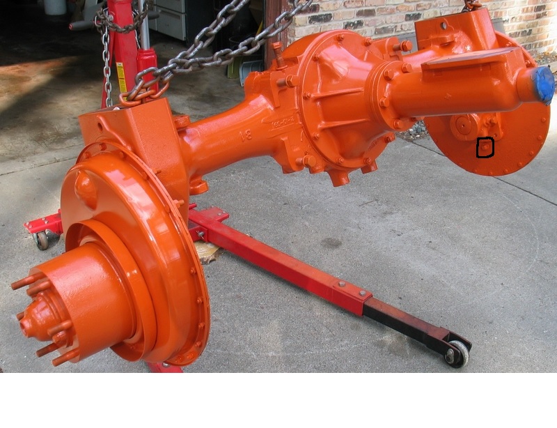

The final drive is filled from the plug hole I have circled in this picture:
The drain is the same size plug on the bottom of the final drive housing.  The final drive housing is separate and shares no oil with the differential.  The brake is in between the two and  should be dry.

Now I now how to fill my final drives.

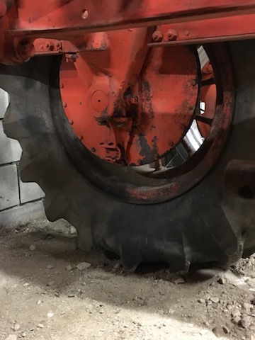

There is something placed before the fill plug, that's why i didn't see it!
At the picture you can see it, why is it?

The piece blocking your fill plug looks like one of the brackets for a mounted corn picker.

Bud: that's interesting, do you know if i can see if the tractor had a mounted cornpicker on other mounted things?
On the side it has also some brackets.
Thanks

If it had a mounted picker at one time it would have been the # 33 I think! they also had a mounted hay bale conveyor to load the round bales that were made by their little baler. Not sure what else mounted in that time period.
I have a 34 and a 36 wc out here ! also a square axle, (dont know year) and one more styled wc with aux. transmission.  thanks; ac fleet
