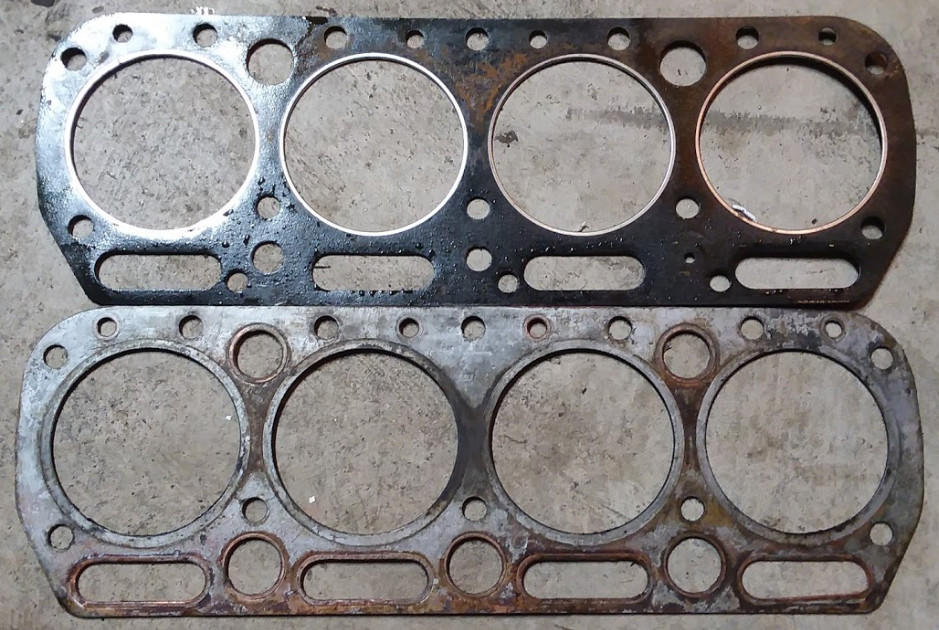

Turning it end for end doesn't make a difference, the head/block is symmetric.
Perhaps I have an oddball block/head or more likely my 15bolt gasket is for something else?
No matter how I install it, I'm literally almost plugging two of the 3 water jackets. The extra 3/8" bolt holes in the gasket encroach on the larger water hole.

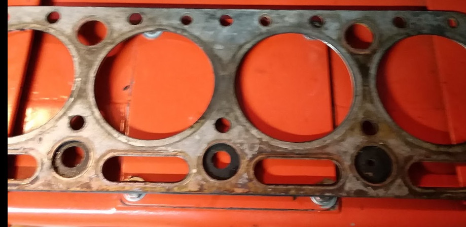

Apologies for poor quality pics:

If you are concerned about the small holes in the newer version gasket, don't be. There are hundreds of thousands of WC-WF-WD-WD45-D17-170-175's running out there with THAT GASKET !!   The small water hole goes towards the radiator.

If those holes are your only issue, just punch them out a bit bigger.  I'm with the Dr.  That gasket is under thousands of functioning heads and I have never once heard of overheating a head due to it.

Thanks for the replies. My biggest concern was the difference in water hole size but also it looks like the additional 3/8" unused bolt holes line up with the water jackets...I guess that shouldnt matter though as its no different than the unused holes on the opposite side of the head. The thickness was quite a bit different also .08 for the old and .06 for the new.
I had initially put the gasket on and torqued everything down and it seeped from both sides as I filled the radiator. Likely an oversight on my part for not coating it with anything.
I've read several different methods from silver paint (the original had this) shellac, copper coat, and I think "hylomar".
I'll give it another go before I pay out the nose for another gasket.

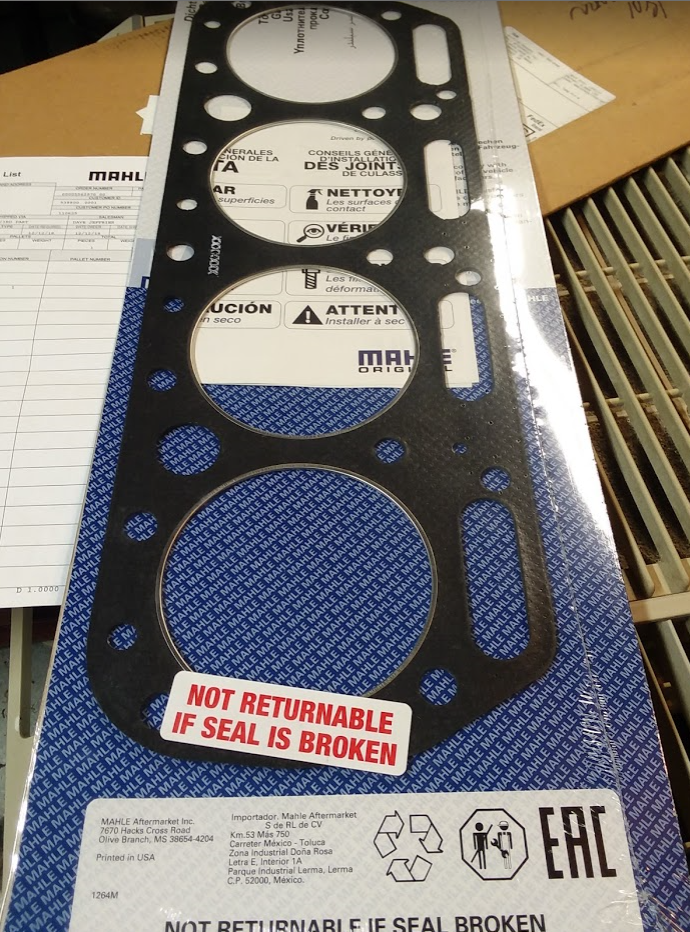

Ordered the part number listed and this is what I got. As far as I can tell mahle distributes the victors gaskets but this is what I got...looks like a step above my previous gasket but still not thick and metal on both sides like the original.  I coated both sides with copper coat, took my time, and this one started seeping as soon as I started filling the coolant.  It was better than the first but still leaky.   I might have to bite the bullet and kick this thing to the machine shop, or the scrap yard.

Jeff, I sent you a PM>

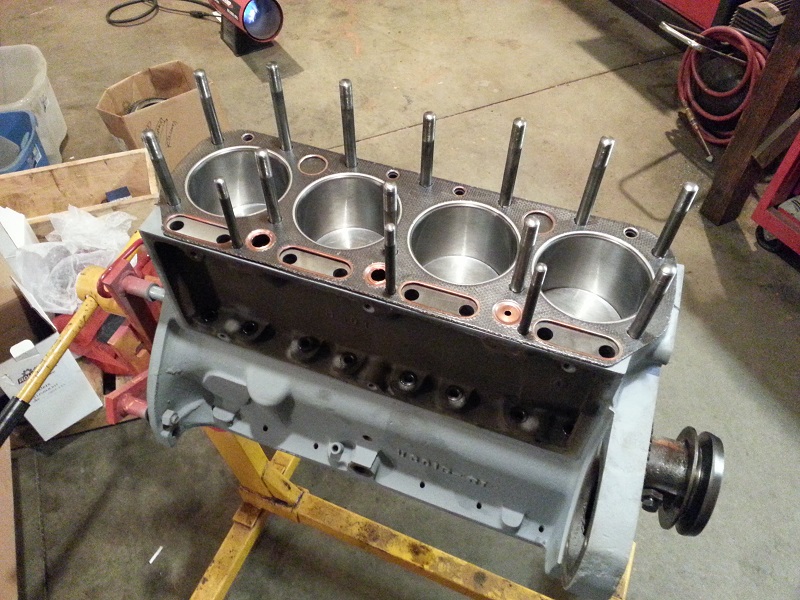

I tried the new gasket coated in coppercoat and it suffered the same fate.
Seeping as soon as I filled the radiator.
There's some pitting on the head at the water jackets that I think was letting the water in. I took some JB weld and filled all pitting carefully, then coated (very thinly) the head/block in the blue stuff (like hylomar but permatex brand). Weird sticky stuff indeed, but a thin coat filled the scratches on the block....I think the block scratches are actually grooves from years past machining but they seem questionably deep.
Coated the first gasket in coppercoat and torqued everything down.
This seemed to do the trick at least for now.
