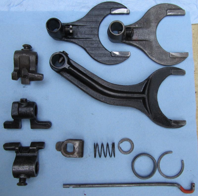

I don't have a picture of just the shifter and the pieces that attach to the bottom of it but here is what all you will find in there.
The spring and the piece on either side of it are what is on the bottom of the shifter.  HTH Tom

That is exactly what I need.  everything was rusted and I did not want to force it if I was missing a key slot somehere. I have it apart aside from the snap ring.  Still need to figure that one.  Looks like a pretty deep groove.
