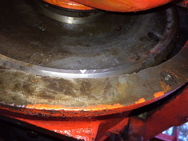

I'm about to reinstall the mag on our '38 WC. I've never done this and I don't own a WC manual that explains the timing procedure. I've looked at other information about timing a WC on the Forum, but the photos and descriptions I've found  are a bit different from what I'm seeing. At this point I have two questions that I'm betting you guys can help me with!
1. I located what I believe is the timing mark on the flywheel rim behind the flywheel cover. There appears to be only one mark - a "vee shaped" notch (about 1/8" wide at its widest point) on the inner edge of the flywheel rim. The point of the notch points at the ground when the notch is at is lowest point. There's no "F" associated with the mark. I marked the notch with white grease marker so it looks larger than it is in the photo below. So....have I found the timing mark?
2. I hand-cranked the engine until it started blowing air out #1 spark plug hole. Then I had to rotate the engine more than 1/2 turn before the notch was at its lowest point as the flywheel turned. Does this sound about right for having the engine ready to fire on #1 - assuming the answer to my first question is "yes"?
Thanks for any help with these questions!
Dave

I may be wrong (not the first time!) but if yours is a hand crank, I believe you time it from the access plate on the top of the bell housing, not from the bottom like an electric start

Interesting! Thanks, Joe & CTucker.
I just thought to check the positioning of the slots on the governor drive for the mag, and they were straight up and down. From what I've read, they should be at the 3-9:00 positions. Thus, whatever I have found seems wrong. So you may be onto something.
Posted above and then saw post from CTucker. Mine is most definitely unstyled with no starter. Thanks for the photos and information. I'll pull that top plate off tomorrow and have a look.

Oh boy. Removed the plate and inspected. I can see the face of what I assume is the flywheel but not the outer edge as shown in CTucker's photo - that's the surface with the "F" stamped in it. I am puzzled indeed.
AHA! With my good wife helping me, we located the "F" mark on the face of the flywheel. Timed the engine and she ran!
