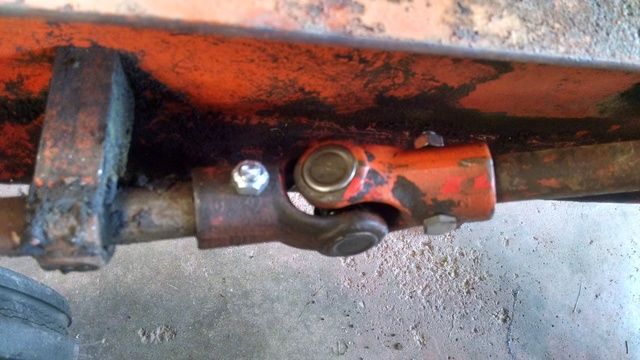

Does anyone have a good number for the steering shaft U-joint on a WC or WD (probably the same?)
Something I can go to Napa and cross, hopefully?
Thanks in advance.

A few of the vendors on here have them.  Steiner has them as well:
http://www.steinertractor.com/ABC167-universal-steering-joints-repair-kit
Post Options Post Options   Thanks (0) Thanks(0)   Quote CTuckerNWIL Quote  Post ReplyReply Direct Link To This Post Posted: 03 Jun 2016 at 9:01am
I bought one for my WC, don't remember where I got it from, but it was physically bigger around. One day looking thru my scrap pile, I saw some salvaged parts from a 60 All Crop combine. The same U joint was right there in front of be except I had to drill the cross holes for the pin. The combine has a key slot and a set screw.
