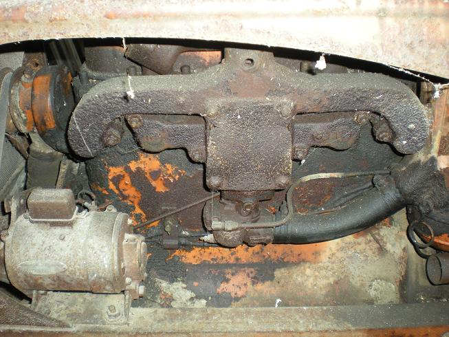

On this tractors manifold there is a plate about 4 1/2" x 4 1/2" with four bolts. I have not seen a replacement that matches it exactly yet.  the only thing I can figure is is like a heating chamber that warms the intake air the way it set up.  I does not open into the intake directly. Does any one specifically know the engineering purpose of this chamber or have a picture of one ?

I would guess around 400 pounds and you probably have a kerosene /low grade fuel manifold which preheats the fuel.

I think you are correct on the manifold, it was to preheat the incoming charge on dual fuel engines

I think the plate was installed 2 different ways depending on gas or kero.  One way it directed,the other it blocked hot gasses.

I am more curious about the manifold though, I was always told the plate was there for one reason but now I'll have to check.  I wonder if I can find reproductions of this?

Along with the bolts that hold the block, it also has a couple of dowels that hold pretty tight as well as the input shaft from the tranny being in the flywheel.  They can take some maneuvering to get loose.  You can look at the AGCO parts book on line at www.agcopartsbook.com sign in as a guest and search for WC.  It's possible you have an aftermarket manifold.  Any chance you can get a picture of it for us to look at.

I'm 95% sure this is the original manifold there is no record of the manifold being changed and Dad is positive it is the one that came on it. and yes he was there when it was delivered.
I don't have a photo yet of it with out the plate but it does not open into the air channels. It would make sense the layout the the chamber that it provides would maintain an extreme amount of heat.  the original manufacture of this manifold would be helpful.  As you can see no identifying marks left on this thing.  Run red hot too many times.

That's the stock manifold for a gas engine. They started using that one at engine #W106509 which would be late 1940.

The side exit exaust was used on earlier engines and all low octane models.

I was pretty sure it was stock and know it is a gas high compression engine.  Does anyone know the engineering reason of the plated chamber?  and is there a reproduction that matches it or is it only the one with the plate with two bolts?

The plate helps direct some heat from the exhaust manifold down to the carb to keep it from icing up and causing poor running.

Thanks Stu.  I will  be using this one.  I've been looking into the repair of manifolds online.  The plate is easy, I've torched it off.  I'll redrill the bolt holes. There are some products out there for repairing and I always could build it up.  but we will see.  If we want to use it It will eventually look like this anyways.
