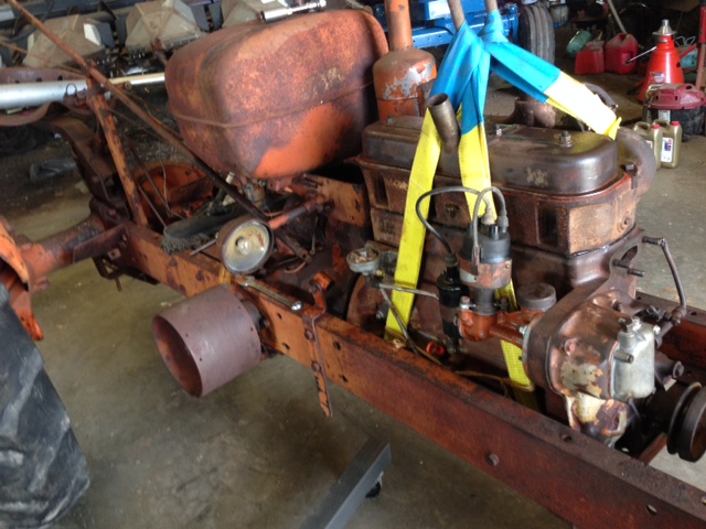

WC is getting a Gleaner E combine engine repower.
I bought VanSickle 172 Gloss AC Orange acrylic enamel paint. Will it matter much on having exact paint color? Its not like the tractor is original. Its not the first WC my grandpa bought either. The first WC he bought didn't have PTO but had a lift type system installed by the transmission disconnect box. He traded that one in on a WD. This WC was picked up at auction some years later and has PTO. He added a pull rod for the starter instead of foot start for the starter. He also put on a seat and seat suspension from an old 10-20. I plan to add hydraulic pump (used on the Gleaner E) were the alternator is and move a mini 40A alternator up near the valve cover under the hood. Still needs lots of work yet.

Post Options Post Options   Thanks (0) Thanks(0)   Quote steve(ill) Quote  Post ReplyReply Direct Link To This Post Posted: 19 Jul 2017 at 7:38pm
as you do more work, keep adding photos to THIS post so we can see the progress !! What is the HP rating on the gleaner motor ?

Post Options Post Options   Thanks (0) Thanks(0)   Quote Sugarmaker Quote  Post ReplyReply Direct Link To This Post Posted: 19 Jul 2017 at 8:55pm
Good shot of your project tractor. Any mods to the Gleaner engine to get it to fit?
Would be a nice upgrade in one of my WD's.
Keep us posted.

Post Options Post Options   Thanks (0) Thanks(0)   Quote jbirnsch Quote  Post ReplyReply Direct Link To This Post Posted: 19 Jul 2017 at 10:19pm
This is a G226 M coded engine. Same specs as a D17 engine but I have a WD governor weighted spring in it which should tame it down a bit by lowering the RPM. With a D17 carb and governor spring max HP is 52HP
So far for changes to make it work I made a cover for the fuel pump hole on the side. I had to bore out the front crank pulley deeper because the front nose of the crank is longer. The water pump holes need to be drilled bigger to fit. Needed to drill/tap the manifold for the muffler support bracket. I needed to add the throttle lever in the timing cover. There was a plug I needed to remove to add the bushing and shaft seal for the throttle shaft. The top adjustment screw hole in the timing cap was plugged with a carriage bolt that was ground down. This was where the max speed was set on the combine as it was designed for Wide open throttle use.
I added a WD45 distributor. It has a WD carb on it since the WC carb was damaged by water in the bowl and froze. It needed a new clutch and ring gear. The ring gear was shot as it was already turned 90 degrees and the clutch was down to the rivets.
The engine was free ($0) but needed work. The head gasket was blown. I removed the head and cleaned it up. The valves needed to be ground and there was pitting in 2 of the exhaust seats. I have a B&D valve grinder and Souix seat grinder. I touched up the valves and ground the seats. First time I ever did this kind of work. Hope I got it right.

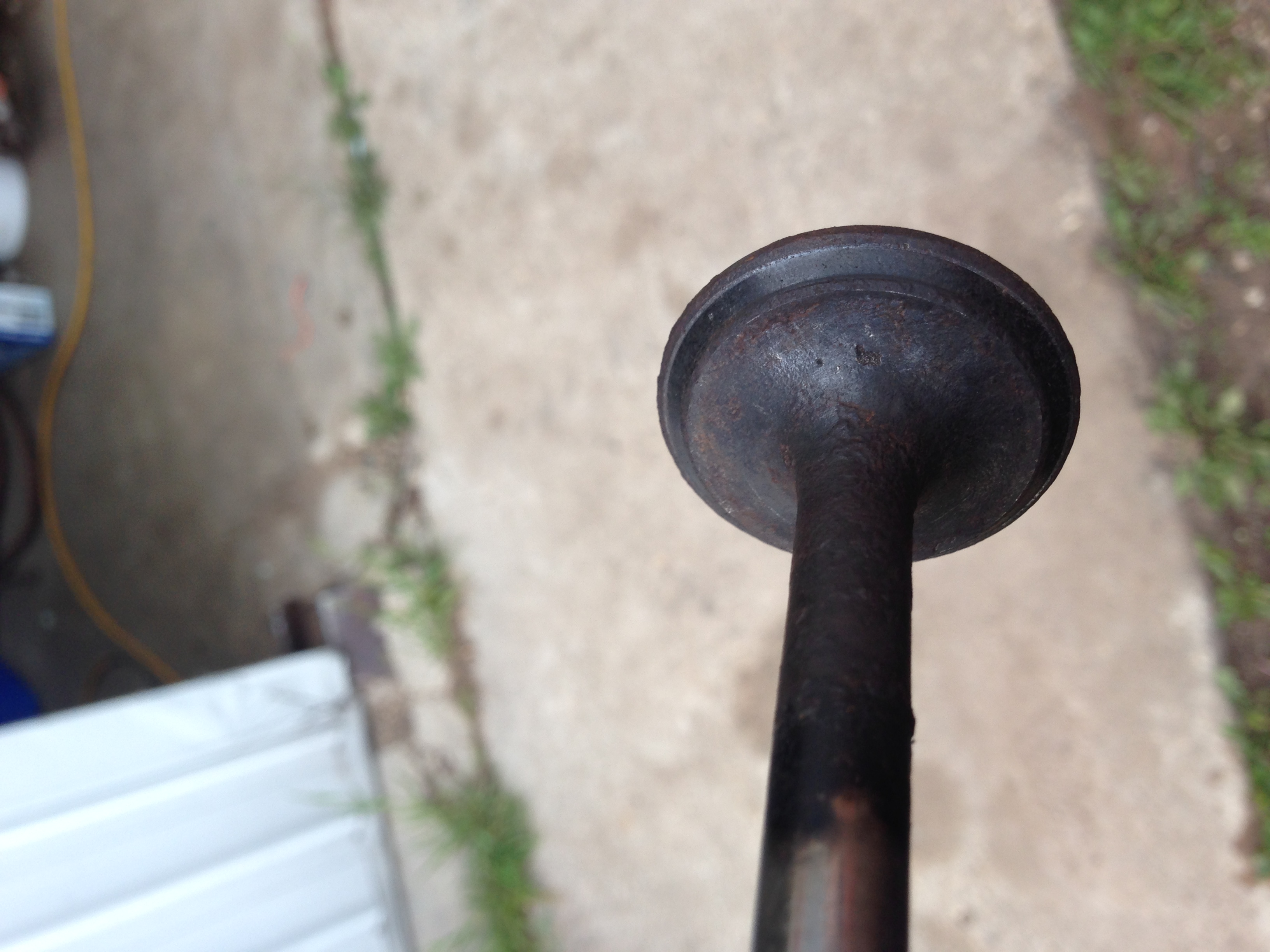

Post Options Post Options   Thanks (0) Thanks(0)   Quote jbirnsch Quote  Post ReplyReply Direct Link To This Post Posted: 19 Jul 2017 at 10:40pm
Picture of one of the exhaust valves.

Post Options Post Options   Thanks (0) Thanks(0)   Quote HudCo Quote  Post ReplyReply Direct Link To This Post Posted: 21 Jul 2017 at 12:27pm
is that one of those new fangled sealing grooves on that valve ?

Post Options Post Options   Thanks (0) Thanks(0)   Quote JC-WI Quote  Post ReplyReply Direct Link To This Post Posted: 15 Aug 2017 at 12:23am
Thats the two step sure seal valve. LOL

The valves were ground and had enough margin left to be reused.
