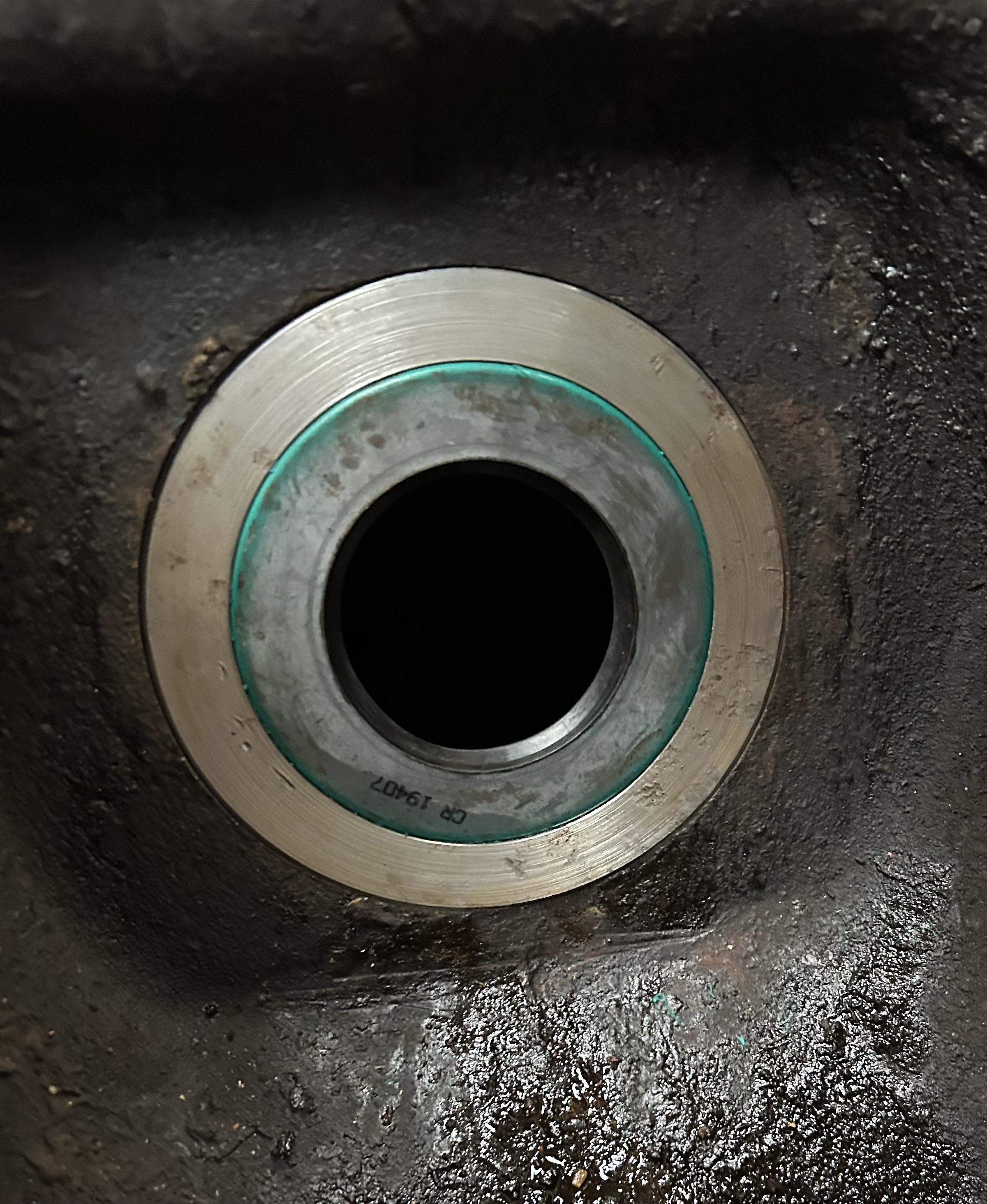

Hi All, i have recently got my hands on a WC to go with the B i have. it sat up for a while so all the seals in the rear axle were leaking. i have the large hub seals ordered but im looking for the inner and outer axle seals. inner is approx 4.25in OD and the outer is approx 3.2in OD. im having trouble finding the inner seal - any thoughts? thanks

The large diameter inner seal is discontinued by all (or atleast all that I have checked, which is a lot) manufacturers and has been for years.  A-C had a kit which came with an adapter ring and smaller diameter seal.  This kit was made into the AGCO years, and has been discontinued.  If you can find them, last i knew most dealers wanted about $120.00 each for the kits and thats only one side.  I know that I had the local dealer check this part on locator thru agco dealer stocks and it is almost near impossible to find.  If you have a lathe or know someone who does, you need to make a steel or brass adapter ring that will press fit (tap in with a bearing or seal driver or carefully with a hammer and punch) into the axle housing and an inner diameter of a seal that is obtainable that will fit the shaft - the 450094 in the picture above would work, which would probably be the same as what you ordered and received if all 4 seals are the same size.

isn’t that the Allis adapter in his third post picture?

Joe - Now that you mention it, I think it might be.  It threw me off a little because it looks smaller than the original type seal, but could just be an illusion.
Mike 207708 was the original number.  This was for s/n WC67328 and up.  72511216 is the Agco number for the kit with the ring.

Thanks all for the support. I’ll bring the seals round to a local machine shop and see if they can whip up a pair or ring adapters. Thanks!

Hi all, thanks again for the info. Couple of adapters made up and I’m sorted! Thanks.

You got it.  Thats exactly what the DR ordered.  Looks good!
