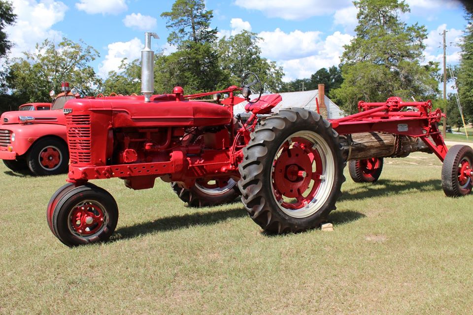

This is a picture of a trip cart on display at Heavy's Barbecue on Hwy 15 just off I-20, the only one I have seen in years. Brings back some memories.  BTW good pulled pork barbecue and stew.

Thats interesting. So the auto rearend drives some type of winch on the other side?

On this one there is a sprocket on the right side that drives a simple winch mechanism via a chain and on the left side is a ratchet mechanism that holds the winch drum until it is released (tripped) by a lever thus the name trip cart. Some have the brake assembly left in place on one side and it is applied to make the other side turn so then the pto can run all the time.

I remember the winches on Pulp Wood trucks in Oklahoma in the 70's were auto Rear ends with a brake drum on one side, pinion driven by pto, and winch half way down the other side, with a home-made winch setup. worked fine as long as someone was holding the MC that kept pressure on the drum.
