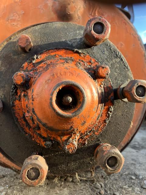

why is this differant right is normaluploads/8753/wc_left_hub1.jpg

Someone put flats on it to turn with a wrench?

why would someone do that to a bolt with no threads and i belive thats the original paint on the end
Points: 22844
Post Options Post Options   Thanks (0) Thanks(0)   Quote DrAllis Quote  Post ReplyReply Direct Link To This Post Posted: 01 May 2023 at 8:56am
I think that's the way the older ones were. Many got converted over to six studs/nuts.

what was the purpose ?  why?

Early ones was that way. Enough bolts for the hp.                   MACK

i just looked up the parts and it says dowel 2 required my right side had one stud that the nut stayed on and the stud came out i would bet thats the one that had the dowel
