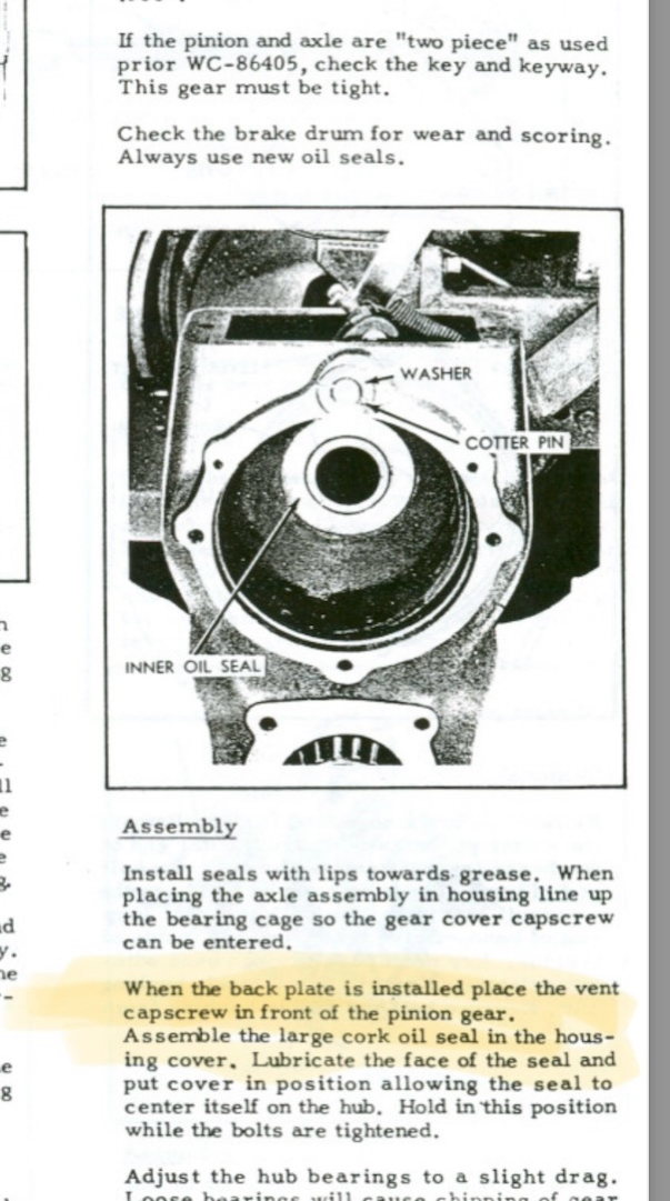

Where does the vent bolt with the hole drilled all of the way through it go in the final drive on a WC back plate?
