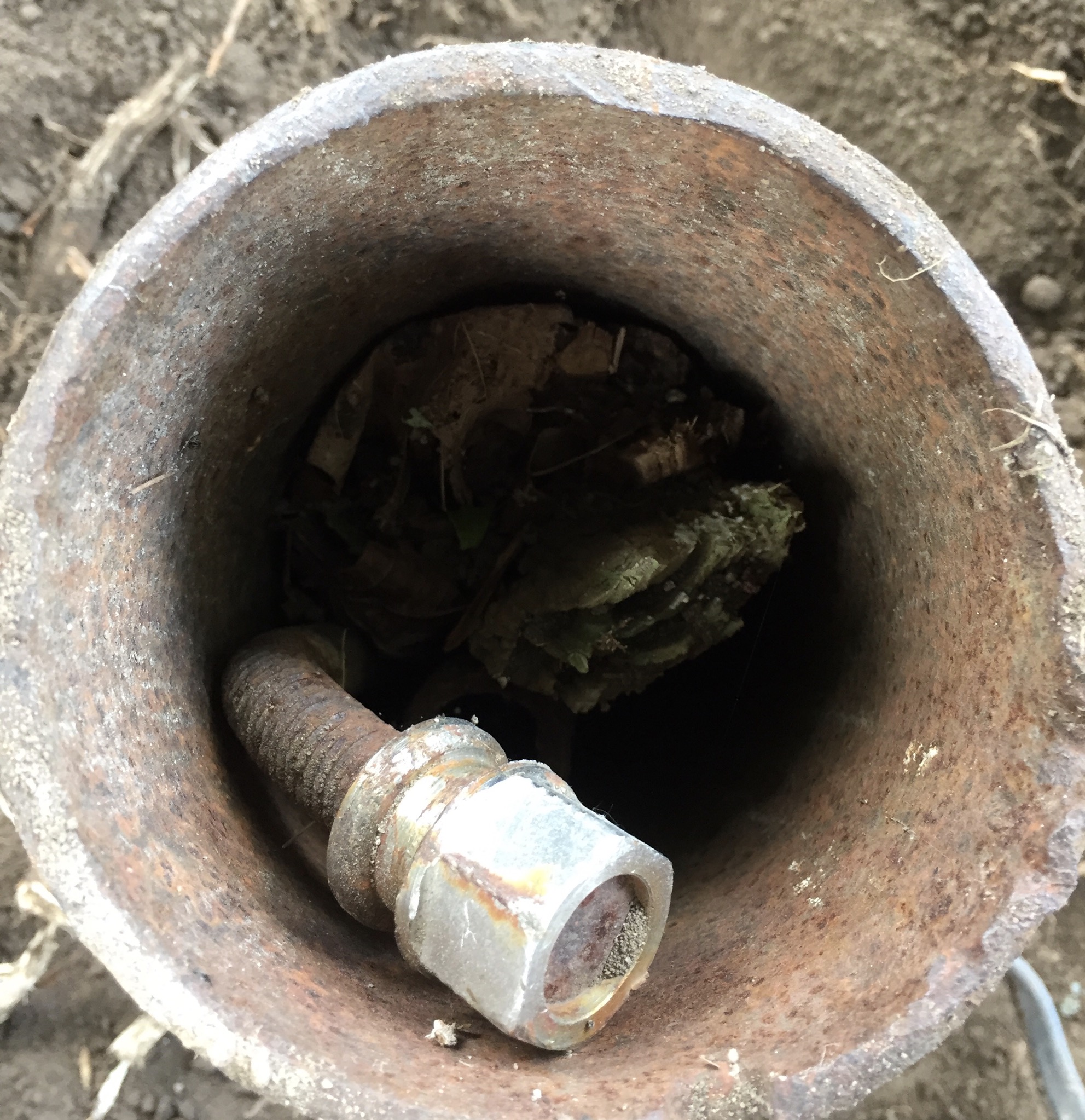

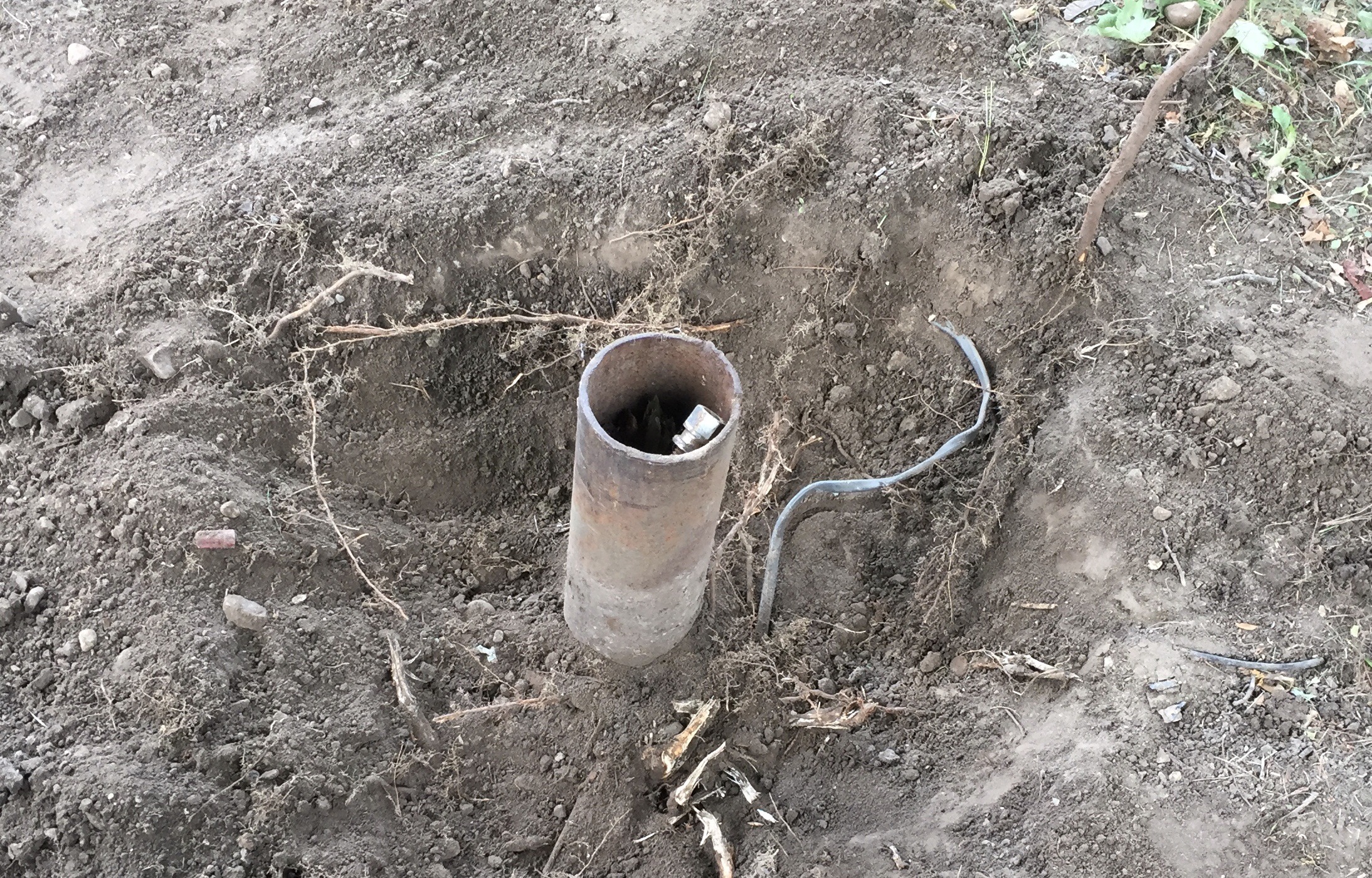

This old well was right at the end of my driveway and is a nightmare in the winter when trying to snowplow. Hit that with the tractor bucket and it will throw you off the seat. My question is, is there any reason I can’t cut that off 6” below the ground? I can stick a tape measure down 5 feet before I hit something solid. Not sure what the rod with the nut in the center is and yes the wire in the hole is dead.

I helped dad cut off a many of them...at least a few... so I say Yes you can cut it off.

If you cut below ground level it must be sealed to keep contaminates from entering the ground aquifer.i sealed mine with a couple bags of quickcrete. Than deregerster it at the county marked it as sealed with concrete. Cut it off and put gravle over it.

I'd cut at least 1 FOOT below grade, not 6", just to be really,really sure. Up here I'd have to do it on a Sunday and hide what I did otherwise 3 or 4 City departments get their noses bent outta shape. To decommision a well, I need permit($1000),eng cert($2000),pro con to do it($3000) so you can see why I wouldn't tell anyone...

When you put the concrete in hang a steel plate ring the size of the pipe a few feet down in the hole to catch the premix, mix it pretty dry too then once get a load in the pipe take a stick to make sure it settles tight dipping in and out of the plug, once a little has set up fill as far as you want.

I assume it’s capped off inside because I can run a tape measure down 5 feet then it hits something solid. Not sure what the fence post is on the inside???
