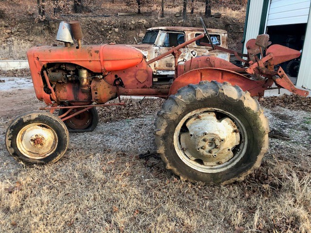

Post some pictures of it. The C is like the red-haired step-son of the AC world. They are great tractors -nfe or wfe.
We'd like to see your new unit and know your plans for it - show/work/re-sell.

the B and C use many of the same parts... radiator, motor, hook, gas tank, transmission, differential, hydraulics, tires and rims.......... what is different is the B is a ONE ROW tractor and the C is a TWO ROW tractor... The final drive cases on the C are 6 inches WIDER than the B... on the front end, the B is always a wide front end.. Steering box below the gas tank has an arm pointing DOWN and a drag link to the left front tire kingpin.... the C has the steering box under the tank with the arm UP.. drag link goes to a SECOND steering box under the radiator.. arm sticks out the side of the radiator shroud.  C can be narrow front, or wide front end.

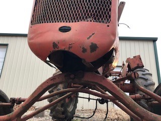

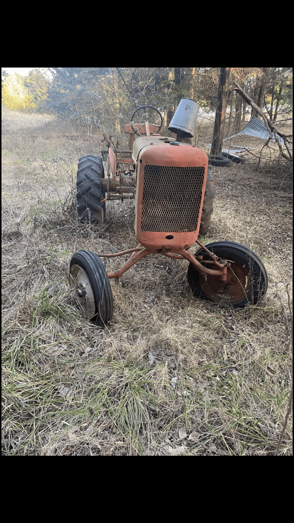

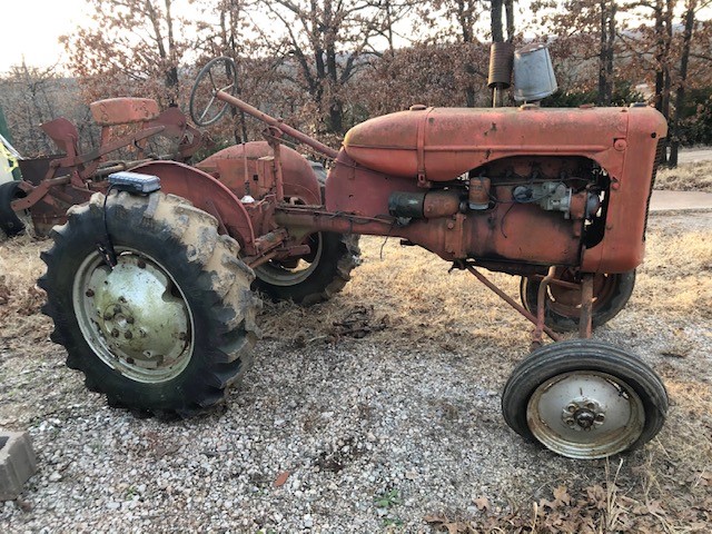

the front end and steering are all from a B.... The back end is hard to tell, cant see the WIDTH.. The 5 bolt wheel is standard on a C and they have a big DISH to them..That looks like what you have............. Probably someone took the transmission and rear end off a C and connected to the engine and front axle of a B.
I cant see clearly on the radiator cover... Is there an opening at the bottom left side where a C steering rod might have been ?

It is possible someone took the front axle and steering box of a B and just put on the C tractor........... you would have a cutout on the left lower corner of the radiator cover.......... From the pictures, the WIDTH of the tractor appears  much bigger in the BACK than the front end.

Welcome!  If you can pull the engine # from the bellhousing mount (left hand side from the driver position, should start with BE or CE), I/we can tell you what year it is.  If it was also from the 1942-1943 timeframe (your C18913 serial # equates to a 1943), it's probably the engine it came with and someone did just a narrow to B wide-front swap.
I have a 1941 with the exact same mod.  I've read that dealerships would do the swap, but I could tell that wasn't the case with mine as the wide front spacers were missing and the toolbox shroud was hacked up to fit the B steering box they had.
Yours looks like a better job.  Only thing that doesn't match the B wide-front is your grill, it is from the C, has the large round cutout underneath for the narrow front. Other than that, looks pretty complete and usable, just needs a battery box and headlights (if needed).  The rockshaft is a nice find too.  With a little creativity, they can do a lot.

You have an "interesting" tractor.  Looks to be a C with a B front.  As stated above the B and C are basically the same powered tractor with a different configuration for a one  row or two row tractor.   As stated above your tractor appears to be a C with a B wide front.
Again, welcome to the forum.  We look forward to seeing additional information on this unusual tractor.

Welcome to the forum!  It also looks like it was an original steel-wheel tractor too, which makes sense with the serial.  It has the rear steel centers and tall air cleaner stack.

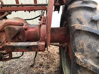

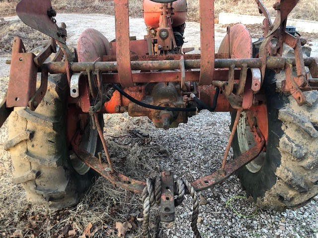

So the rockshaft is not a term I am familiar with.  I assume it is the piece on the back of the tractor that acts kind of like the three point on my other tractors.  What implements work with it?

The wide front makes it a far nicer tractor than a narrow front. Congrats on your buy. It'll make you a nice addition to your fleet. You could find a pull type plow or a mounted plow made for the B/c tractors. They made a mounted mid mount mower for that. Grand dad had 1 on his C. He put a smaller pulley on his PTO shaft so the sickle ran a little faster. It made a nicer outfit to mow hay.
Correct.  I'm a bit out of my depth on the implements, but single bottom plows seem to be the most common.  Also seen different cultivators & back blades, not sure what all was modified to fit and what came from the factory.  You can also use it as part of a three-point conversion.  I welded an arm on mine as part of the lift mechanism for my front mounted snow plow.  Possibilities are endless!
The two hydraulic ram setup on yours is interesting.  Appears your rockshaft is solid all the way across, so they are working in tandem, I assume off a single control.  Most units I've seen with hydraulics have a single cylinder.

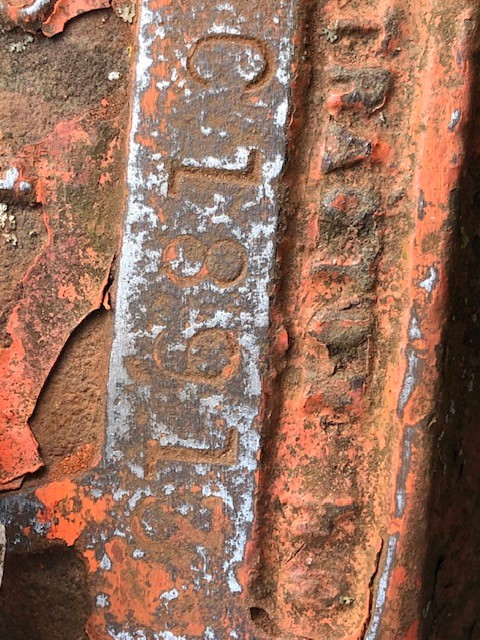

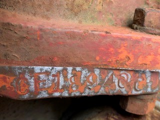

The engine number appears to be
CE189400 the last number could be a C it is not perfectly clear. Does that jive with it being the same age as the transmission?

the most common implement for the back, run by the "rock shaft" would be a single bottom plow..... below is a picture of  a plow beam with the plow removed and a blade fabricated to fit the beam..
another common use of these tractors is to install a belly mower for cutting larger yards and field maintanance.

It's too bad that you just got the tractor and you already have to take off a rear tire and turn it around.  I hope they are not full of fluid!

The last digit is typically a "G".  CE18940G is mid to late 1942.  Most likely the original engine for your early '43.

Welcome to the best darn AC forum on the planet! As the others mentioned, it looks like you have a C model with a B front end. Sometimes they get changed because of the way the owners property might have been a little hilly, where the wide front has much more stability on hilly property. Good luck with it!  Looks like a great start!!

the two cylinders are used when a corn planter is mounted to tractor
