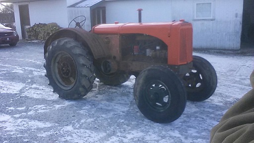

I recently bought a 1938 WF ser#1044 so I thought id post a picture of the tractor. Also I was wondering if the front end parts and bushings are still available anymore? Thanks Zach

I restored a 1937 WF and yes the bushings are still available. They are standard diameter. I had to rebuild the front pivot as that was completely worn out. Had been welded up and ground down to fit which was also worn out. I had a new pin made and resized the hole. Then put a grease fitting in it.

Doing a nice job looks a lot better than it did for sure.

Ok thanks Rog(NCWI) the grease fitting is a great idea.

Thanks Gary
