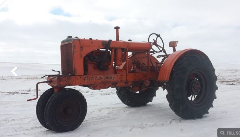

EDIT: 37 was still black judging by the mecum auction original paint wc:

Just trying to digest the information and figure out what to believe....in the first pic, the wheels and fender are the same shade of gray, leading me to believe they are the same color? Anyone else have this feeling? I agree, it kinda looks black, but so does the fender, steering column, etc.
In the 2nd photo....I thought the 37s came with dish rims on the rear, like in the first pic, not spokes like the earlier ones.
Again, I'm not arguing or being disrespectful, I'm just trying to weigh things out and interpret them the best I can.

Yeah after I posted that pic I figured out it wasn't the best one to use....

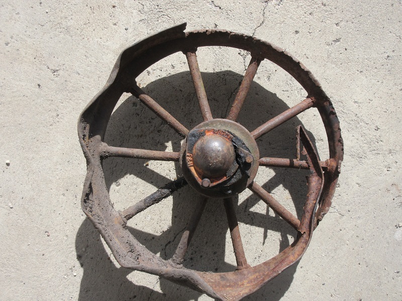

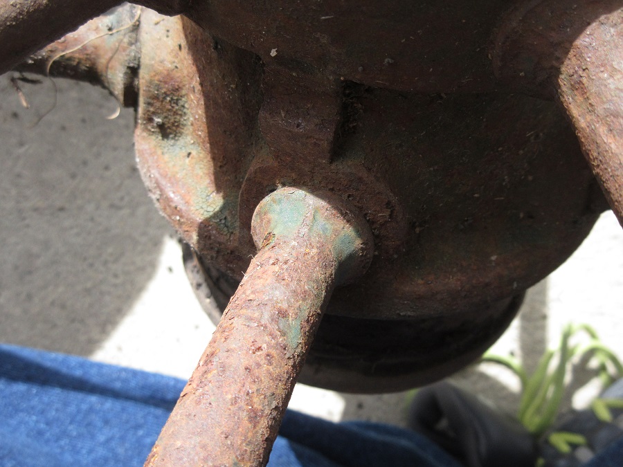

Here's a picture of an original 17" WC front with remnants of F&H green.

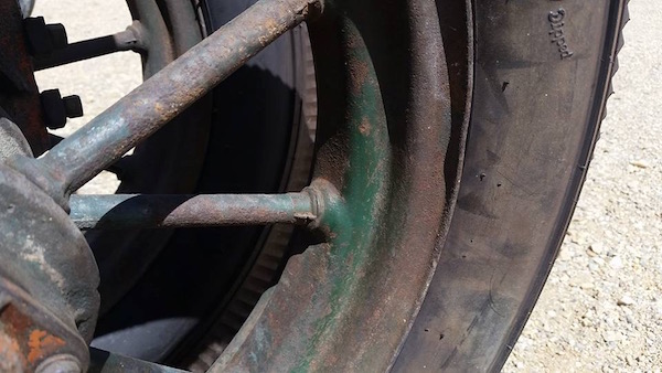

Hard to see in my pic but mine matches that one, my serial number is 970:
Nice picture.  Is that the typical HC111 hub?

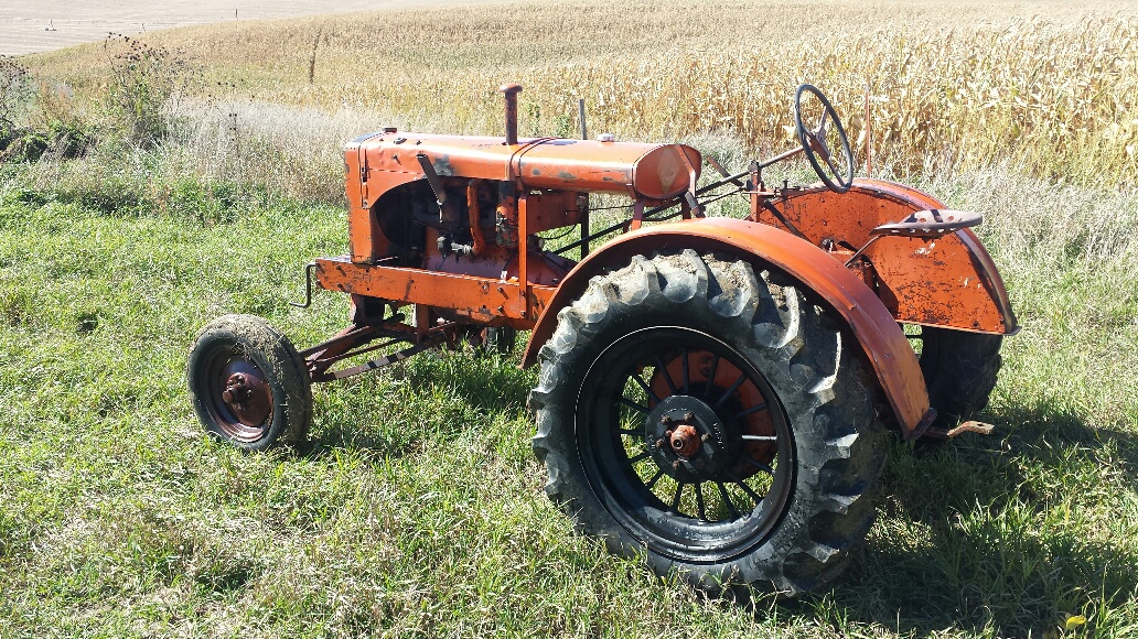

Here is a one my brother james had and it had 28 inch rear spokes. And the big hub 5 bolt fronts. The fronts were very rusty but I do believe they had black paint but so hard to tell there was literally no paint it seemed left on them. I do know I have seen some 5 bolt hubs on an original 37 wc and they were orange.
Yep HC111, I definatly need to have them re rimmed though, what's a good place to have that done?
www.allischalmersarchive.com
Your Source Of Free Vintage Allis Chalmers Brochures Available For Downloading
ecclap View Drop Down
Joined: 24 Jan 2016
Location: Iowa
Points: 52
Post Options Post Options   Thanks (0) Thanks(0)   Quote ecclap Quote  Post ReplyReply Direct Link To This Post Posted: 22 Feb 2017 at 1:11pm
Contact Detwilers in Wisconsin.  If you are on Facebook, Pat Detwiler is the guy that does the wheel repair or I can find his email address for you.  Last time I looked into it, the 17" fronts were a little pricey to repair because Coker tire is the only place to buy rim blanks in that size.  Pat Detwiler can make the wheels look just like they came from the factory.  He can even take ones that have been cutdown to 16" back to the correct 17" rims.

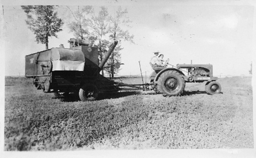

Picture from the day my Grandpa brought home a new WC and combine in July of 1938. To me, its clear the rims are black, with orange bolts.
