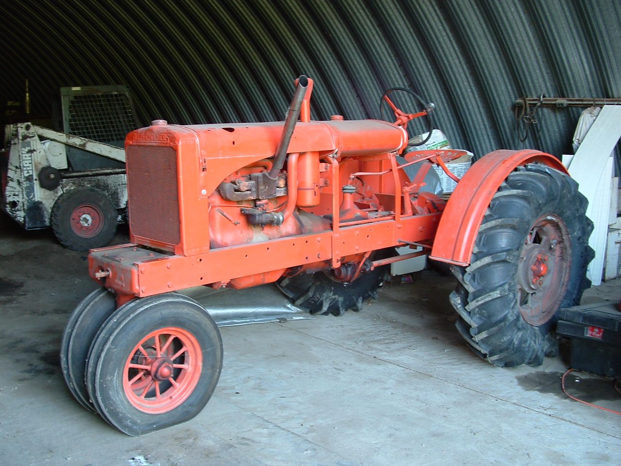

Does any body have 14.9 - 28 tires on? How much clearance do you have between fender and tire? I am trying to figure out the largest tire in any wheel size that will fit under the fenders. Thanks, JM

I think that size is what is on this tractor, but it is at the farm- drop me a PM with your email and I will follow up in a couple weeks when I'm down to the farm.  There is not much clearance with the fenders, but they look good.

I am wanting to say that mine are close to that size. Mine is with my cousin and uncle in Mt. Sterling for the time being so I couldn't tell ya right off. I will check when I go back.

i think they used 14.9, 24 tires on them.

That spoked rim is 24" not 28" I think the 14.9x24's look real nice on a unsyled WC !!

Mine are not spoked. I am about positive that mine are 28"

Unstyled WC's never had 28 inch tires. 28's started wit WC81757
Disc rims started at WC59636 and had 11.25-24 inch tires which are equivalent to 14.9-24's now.
