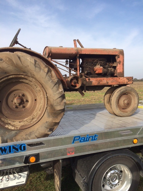

This is our family's 1936 WC.  Just got it out of the crib this fall after sitting there for 34 years.  I believe it originally came with steel wheels and the rubber tires/wheels came later.  FWIW.

Brian,  Nice looking "flat top" WC.  You know, that is the first Allis Chalmers Tractor my father sold.  "Flat Tops" have a special place in my heart.
Take good care of it.  It is a FAMILY TRACTOR

Brian, are those the correct rear wheels for a 36? I've been following this thread, but I'm still a little confused. Like when the OP said "35 is F & H spoke and 37 is dish". I know what the spoke wheels look like, but are those in your photo the "dish" wheels? I have a 37 WC with styled rear wheels and I'd like to get correct wheels to go on it.

Those are the "dish" style. I have a set if interested
According to the Parts Catalog 59636 started the one-piece dish style rear wheels.  That's when the round spokes ended from the factory.  Everyone has to decide for themselves what wheels they want to put on.  Absent any specific shipping info for each individual tractor, we can only tell how things were shipped by the serial breaks in the parts books.  You also have to keep in mind that dealers were probably free to swap wheels to suit the needs of the customer.  French and Hecht also sold their spoked rims aftermarket well into the 40's and possibly the early 50's.  They lost most of the contracts to supply rims as original equipment so they turned to the aftermarket to continue selling them.
If you had a tractor on steel yet in the late 40's you had many options to convert it to rubber.  If you went to your dealer they would probably sell you whatever was currently in stock that would be a proper replacement part.  If you went to a tire shop or hardware store, they would sell you F&H spoked wheels or they would cut down your steel and weld rims on for a lower cost.  That's why not every tractor will follow the serial breaks, especially tractors shipped on steel.
It's probably like ecclap said, the dished wheels were obtained later and were not original equipment.  My great-grandfather was known to be frugal (aka tight) and my guess is the steel wheels were the original equipment for this tractor.  Sometime later (my guess again) is that they chose to buy some rubber tired wheels for it and the dish style is what the dealer had available.
I'll post some more pictures in a new thread/post.

Brian, double check your S.N. Your hood doesn't have the curved tin that goes down to the radiator. Could yours be a 1935 or maybe an early 1936? Also, if you had flat spoke steel wheel, they were painted orange. Round spoke for rubber tires were painted black. I have seen one early WC with factory green round spoke for rubber tires.

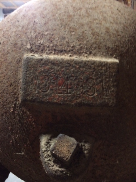

Ours is an early 1936 model, serial # 14981.  Again, not sure about what might have happened to the hood... was well before my time around the farm.

brian' your #14981 is a good one 1934 should have 24'' spoked or steel' don't know wear some look up these numbers' but there not right' i also have two 34's yours looks good. the black book from out of the plant don't lie''#22816 starts 1935' will look for your tractor at some shows this summer.

Rearend could have been swapped out at some point.
#14981 is not a 1934 WC. Could you post the complete serial # list for WC's where you found that information?

Green wheels werent factory installed. Allis painted them black from the factory. I assume they recieved them bare from F&H. If the dealer installed a set of F&h wheels a used or new tractor in the 1930's they were dark green (this was F&H's color) during that period.
Our '35 UC has a set of F&h round spokes and they are dark green. My grandad bought the tractor during the summer of 1941 with those wheels. It came new on steel. We know this because 4th gear was blocked off in the transmission until the 1950's. Plate removed when a new clutch was installed.
I know farmalls (regulars, f20 etc on steel were shipped with no lugs or guide rings installed. They were included in a big cloth bag for the dealer to install.

14981 34 in the wis' plant book i got from a old timer that worked there for years an bought a farm 2 miles from us. helped me work on ac tractors' gave me the books when he could'nt see good anymore. it went from 33-48' i was about 13' years old at the time' i can't call it a lier . what year is 1006?

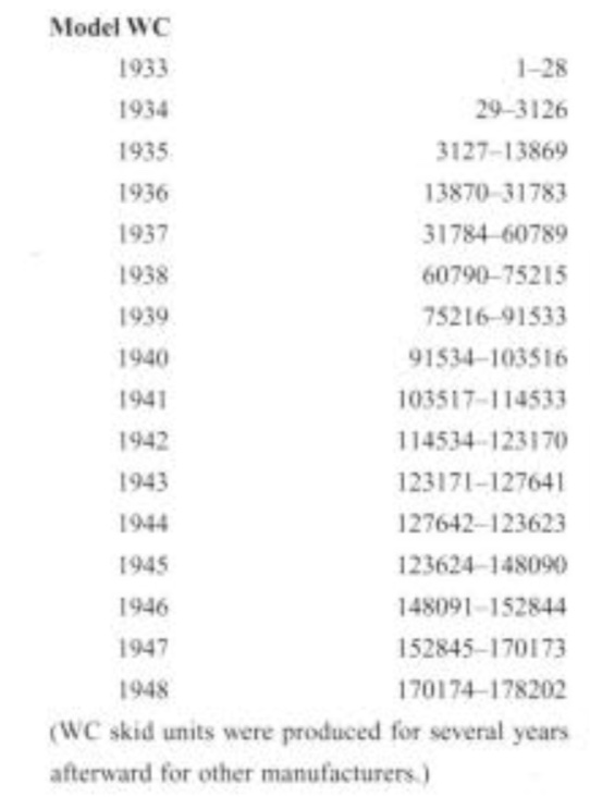

This is the list I see printed in all of the Allis books including the Norm Swinford book.  Is this not accurate?

I'm pretty sure everyone who has a WC uses the serial # list that ecclap just posted, except for one person apparently?

CALEBnOK Thank you for the history on Green Wheels. That is great to know that they were repainted from green to black at AC.
As for the curved tins, the U and UC got the bigger 318 engines and 3/4 fenders in mid year 1936. I wonder IF the curved tin were added to the WC, U, UC, and A in mid year 1936? Any thoughts on this?
