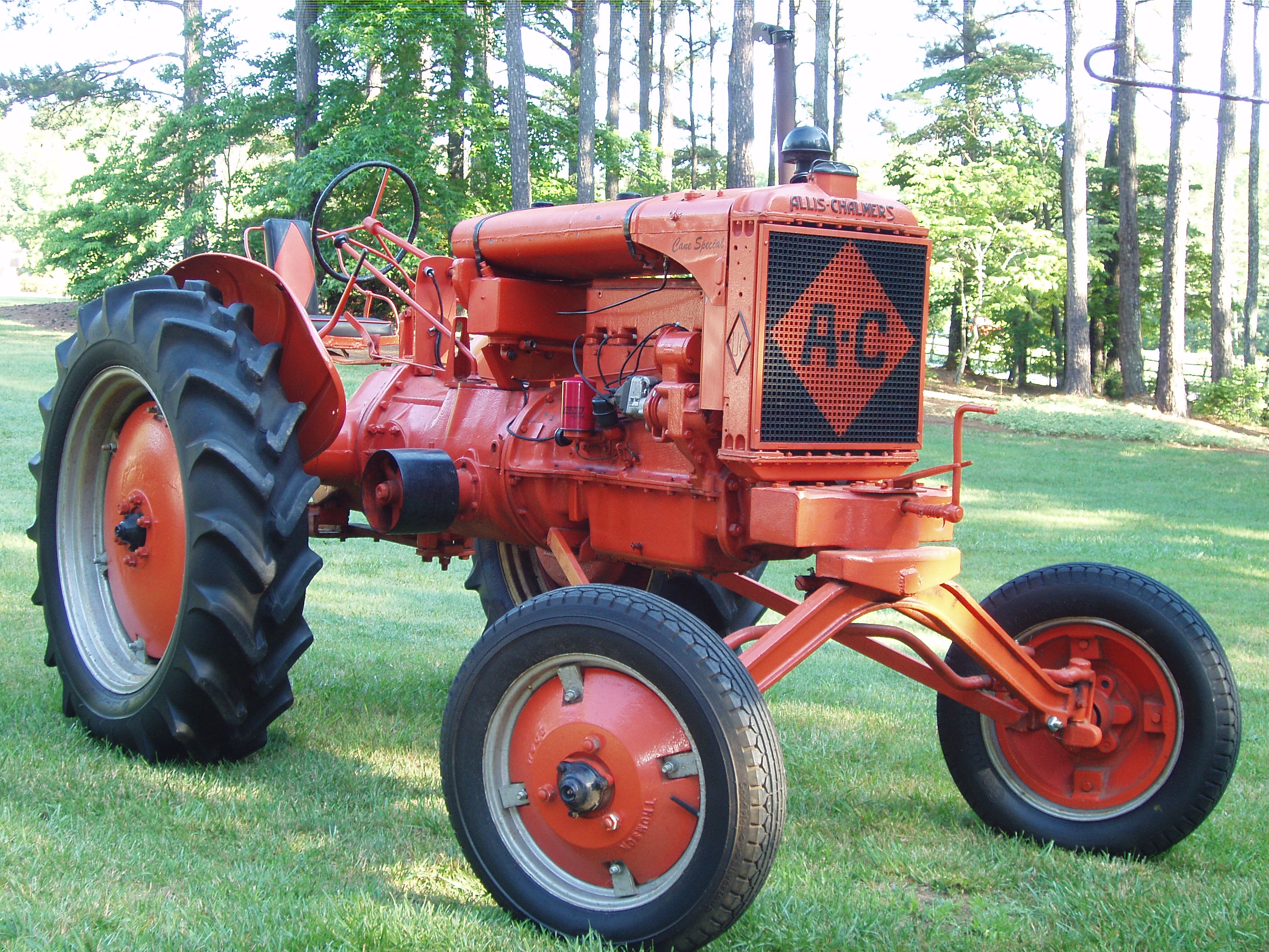

14.9x38's on thick cast on my cane

41 WC,48 UC Cane,7-G's,
