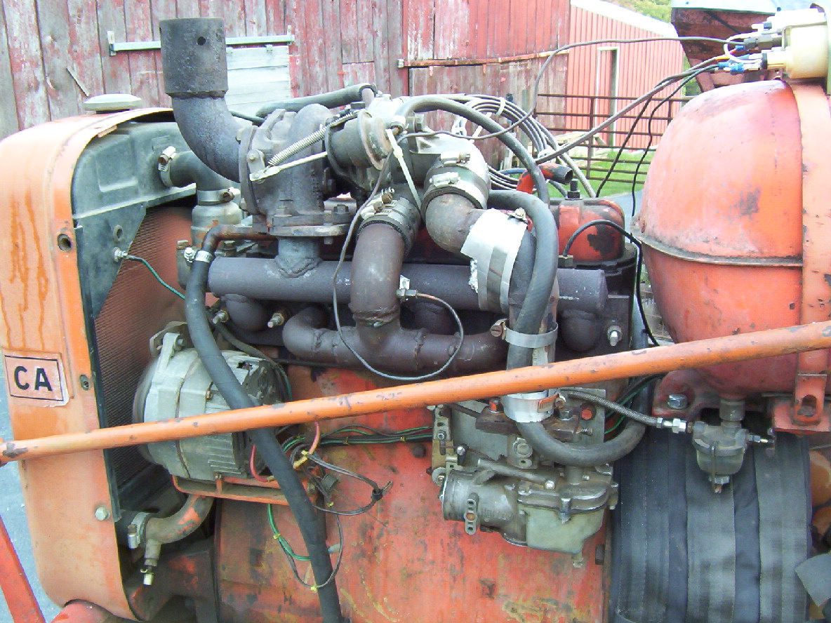

I would not even try to turbo a BE/CE block for all the reasons above. I have done it on the smaller D series block, with the full flow filtering oil system. This block has lots of advantages and address all of the BE/CE shortcomings.  Here is a picture of my setup, which I would consider selling. If either of you is truly interest send me PM with your email address. I can send you more details and pictures. I have also used a reworked P/S pump to have about 50 psi in the entire oiling system.

I would buy him safety glasses and ear muffs...  :-)   better check out the psi required to run a turbo... and Paulb that took some TIME - good looking job.  what is the waste gate set at and what kind of HP did you get.   The turbo was off a?
