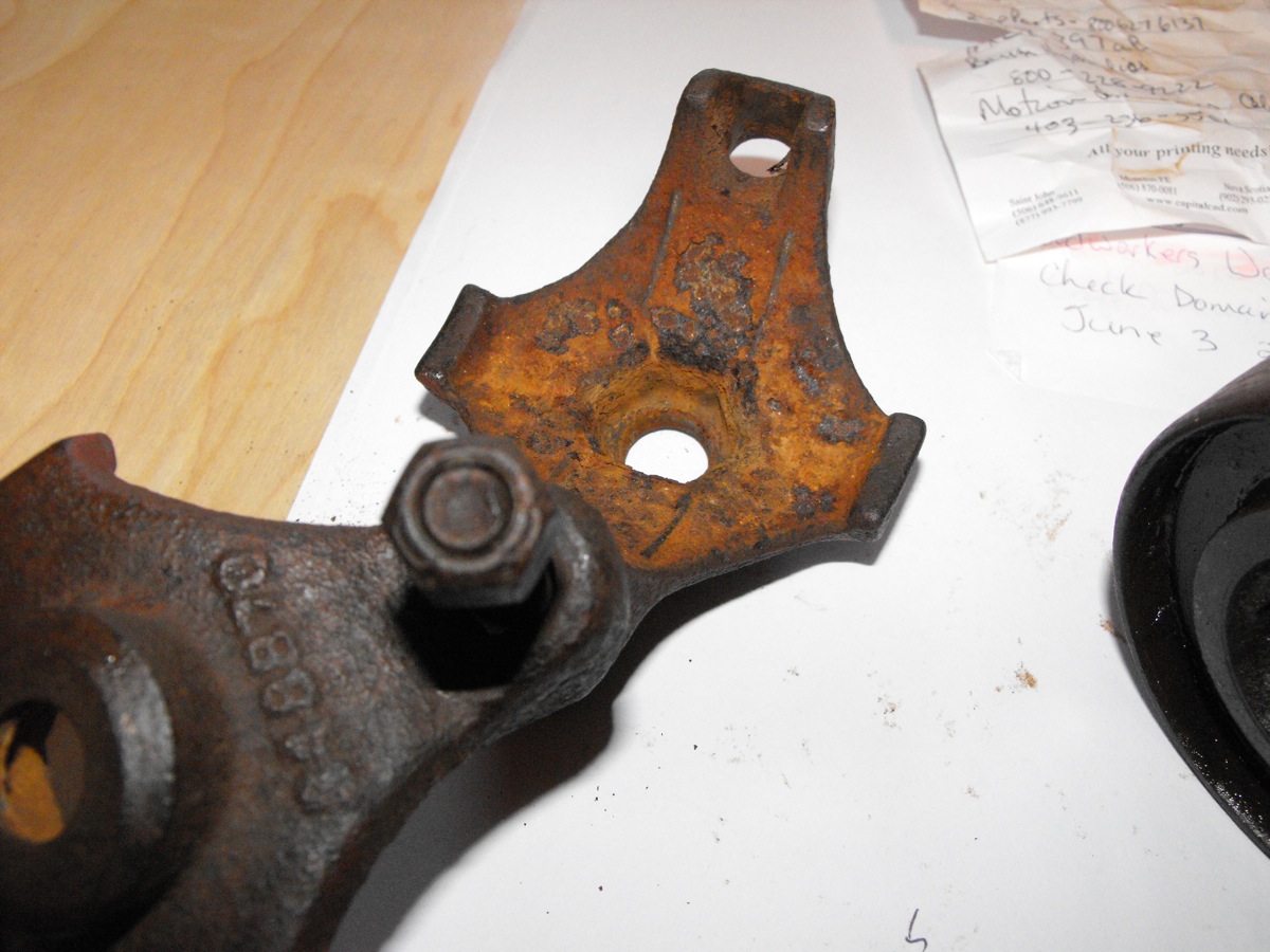

Hi folks,
I'm going to add some photos here in hopes someone call assist in searching for these two parts. Any help would be sincerely appreciated.Allis Chalmers Bearing 333681 and clamp 348870

shoup doesn't carry anything with a hex bore
motion industries (local shops) don't have anything either
baum has nothing
Edited by JimBarry - 05 Oct 2012 at 7:52am

The ole "Ball-Pak" one of a kind and NLA. There are some used ones out there. When still available they were over $200. I think some one fitted a couple brgs in a tube and shimmed the bore to make a replacement.

This farmer is looking for 6 of them. He did go to a local machine shop to see about getting them made up. Apparently he can get the inner part, the bearing itself, but its securing the bearing to that outer housing, which nowadays would be a piece of steel pipe. The thin metal housing of the bearing doesn't offer much to weld too. Then there's the issue of protecting it with a rubber boot.

I'm no machinist but there are quite a few on this site that are, so... if there inner bearing is available couldn't a peice of heavy walled tubing be machined for a press fit and would that hold the bearing in place with out welding?

Ah yes, as Steve M said, the one-of-a-kind Bal-Pak bearing.  Made of unobtanium.  May be able to find some NOS; check with Larry Swenson.  I got some from him a while back but his were with round centers versus the hex shaft.
Here is a picture of the round shaft bearing
It is 3" in diameter; center hole is 1" in diameter; the bearing is 2.5" tall.
Another view.  These are the type I got from Larry.

What's "NOS" and where do I find this Mr Swenson? Your've looks the same except for the round bore.

Using Baums or Shoup's on line search is a waste of effort.Baum does have HEX bore disk bearings, download section Q, look at page Q1. But not wide and not 1" bore.
In section P, Baum has hex bore weldahubs. They machine nicely. I would use some bigger disk bearing (from Baum or Shoup) with a hex bore weldahub and a universal bearimg mount also found in Baum section Q. It will take some machining.
Shoup's 2006 catalog shows several bearing with 1" hex bores. Look for part numbers:HPC100GP, HPS100GP, SH10338 (replaces JD9338), SH10313 (replaces JD9313). There may be more.
I have multiple solutions. Use a machined Weldahumb with hex bore as a spacer for a disk bearing with about 1-1/2" round bore and cobble a bearing mounting from standard parts, or I have to 12' wide JD disks sitting around and I'd put one of them to work.
The 2004 Shoup spring catalog shows a 1-1/4" hex disk bearing for Allis. They may not have them now.
It would be possible to shim the 1" hex shaft to fit in Baum's bearing with a bigger hex bore, but machining a weldahub hex bore round is easier than machining its outside hex or square, but all are possible.

the bearing is ROUND the center here is a hex inner sleeve. Press the inner sleeve out, then the bearing and replace as in the 70330133. Less than $100 to put/press in 2 brgs. Save one spacer to put between the 2 new brgs add a flat washer on each side as a dirt shield. Will last years..
