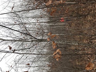

I have a LOT of small trees to pull -basically a forest full of popple (1"-5" diam) and am wondering what is the easiest method for doing so. There's a lot of grinder attachments for skidloaders, as well as large toothy clamping jaws for yanking trees out of the ground. But I haven't seen anything that would attach to a snap coupler, pto, etc on an Allis. Does one exist? I saw this on YouTube and thought it'd work great!
https://m.youtube.com/watch?v=Y9zq24vJSic
Or if really, really thick, just say to heck with it and find a crawler to rent and just bulldoze my way to opening the area up?!

This might fall under the category of- If you have to ask, you already know.....
Here is a pic of the area needing deforestation!

X2 on renting a small dozer. It will save you lots of time and lots of aches and pains.

Just curious what are your plans on what  to do with the land after you clear it? Bulldozer will make a really big mess and take a lot of work and $$$ to get it back into any shape.On the other extreme take a chainsaw and cut the trees off ground level and mow over them will kill the stumps.That will disturb the ground the least and cost the least. I've cleared some land like that but instead of mowing I put the goats in the keep everything down.

Probably cheapest to have a forestry mulcher get at it.

Don't dozer it, you'll end up with piles of dirt with trees mixed in.  If you get a dozer make sure it has the, not sure the correct term, claws on the back.  drive around with that in the ground and then go pick them up and throw them on a burn pile or trailer.  It'd sure beat the heck out of sitting on a tractor looking backwards for many days.  And the best part is, you'll still have all that good topsoil!

Trees that small are fairly simple. Do you know anyone with a backhoe with a thumb attachment.   There is no match for the use of hydraulics.  The trees come up easily and get shaken, dirt stays on the ground and the tree is swung around and piled.   I've done it countless times.  There is virtually no dirt left on the trees in the burn pile so clean up is a breeze.  The backhoe also allows you to back fill any holes, remove stones, dig up old stumps etc.  The only time a backhoe is not the right option is if the trees are thorn trees.  Tire repairs seldom make me smile.  In the case of thorn trees just use a mini excavator with a thumb.  Same approach and no tire repairs.

I'm still wondering how much land you're talking about. If 'just' an acre, then sure a small tractor /loader setup would work, though take a lot of time. You could drag a rear blade backwards and knock down the smaller ones(2" or less) and tow tandem dics to chop up the fallen. I did that for a neighbour,worked ok. The problem I see is size. Jump up to say 10 acres and yeesh that becomes a huge project. Then you'll need bigger machinery to do it in a weekend as opposed to a summer long project. Late Fall, early Spring would be the best time to do it. While a dozer would make a bit of a mess, it's fast and you can level off the land. After that, tractor with cultivators can  get the 'twigs' into windrows and then burn them off. Run discs after that and you're basically done. How you do it depends on time and money. How much 'free' time can you allocate to the project ? It may be better renting a dozer for a weekend, do all the 'rough removal', then do the final cleanup when you have time. Just be sure to do it BEFORE new growth appears or you're back to square one !

A lot depends on what you are going to do with the land after it is cleared. If you are going to attempt to plow it, you want all the roots gone that you can get. If you're going to broadcast grass seed and pasture it, you don't have to be so fussy.
I like Arcs and Sparks idea of a backhoe or an excavator with a thumb. Not only can you remove the tree, but you can easily load it on a dump truck or trailer to get it out of your way. If you are doing much area, it's much faster and cleaner, than pushing everything with a dozer.
