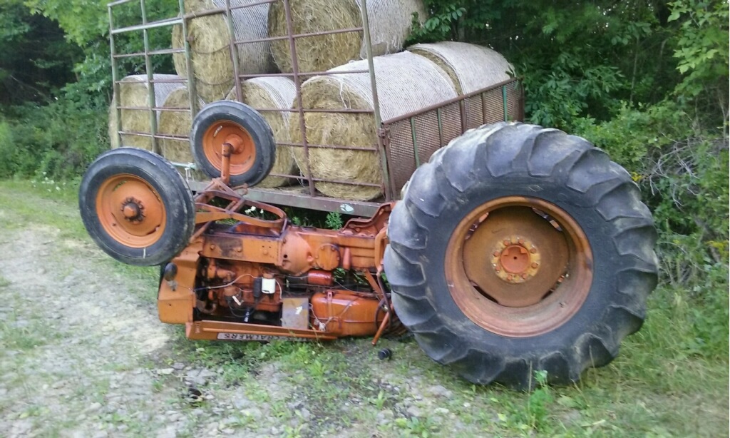

we where where able to find a pair of combine rims and 26 in tire for the D-14,,got them on and went for a load of hay [if some one can post a pic for me off cell phone you will see the results 607 972 6443 ] thanks Ed

well , just put the combine tires on ,and before dinner I,ll try them out,,went to the top of the hill to bring down the load of round bales, coming down everything was just fine, tractor holding back good ,,back fireing a little,,than the tractor went to an idle,i looked back to see the hitch had broke and the wagon about 6 in from hitting thr rear tire, when it hit I bailed,,,the rest is in the pic,,,,, thank Glenn for posting

Wow, you sure were lucky. I remember reading about an accident like that in NY w/in the last two years that killed the guy. He had to much weight in the hay wagon, brakes not adjusted right, and steep hill. It pushed him and jack knifed. I weighed a dry 4X4 round bale. It weighed 550 lbs. You've got more in that wagon than your D14 weighs I think. Plus that's a thrower wagon, there's a lot of weight to hold back empty. Tim

Tractor data shows a weight of 3500 for the d14 so you are right the hay alone would out weigh the tractor.   That has me thinking as I was planning on pulling a hay wagon with my d15. I hadn't really thought about that because we always just used the 100hp 4wd Same tractor to pull the hay wagon back in the good old days. I think that was because you where lucky to get a Same to do that much work. The difference between a Same and a Deere is with Same you did get what you paid for.

Wow glad you are OK. Friend did something similar with a 400 bu gravity bin that was too heavy for a D-14 but only ended in a jackknife with a damaged hood section. This is why my new 600 bu. gravity wagon has four wheel surge brakes.

I'm thinking you lock the front axle, then pull it sideways ?

I am guessing it is already up right.   I would have tried to block the rear tires. Then hook a chain on the front somewhere and pull it backwards and up with a center of rotation on the back wheels. That is how I flipped my 4 wheeler once.
