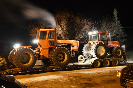

Sweet pic. thanks for sharing. Looks like you have the 855 in 8550

winter service??? what all do they do..that you can't?

I see N.D. wind in the exhaust of the big tractor!!

i guess service is more like rebuilds 8030 will get split new rear seal rods and mains front axle rsealed new stering cyl ends scv cables power shift and range shift cables lights replaced now the 8550 after 11 years farming  close to 2000 acers every year we are going to split engine off new tourqe limiter, reseal pd trans make sure drums are not cut might need new low spd clutch plates, kit inching valve on trans, drivelins have both been converted to hanger bearings without cv joints but now they need new slip joints ,as far as what they can do that i cant nothing, we are on call 24 7 for our business in the oilfeild my farm is 3 miles from bakken dicovery well to get these tractors fixed they are going to hoople 300 miles east thanks for looking     MJ

Yes, that does sound like a little more than winter service...they will be ready to get back to work.

That is one Nice looking load. Makes a nice picture.

John, you either need a smaller truck or a bigger trailer!!!!   LOL   Armand
