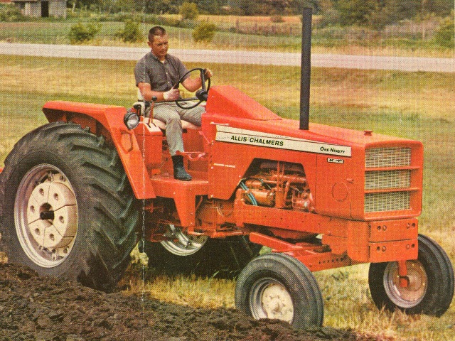

     I  Picked UP A Front Weight For MY  190 XT  ITs one peice  Measures 12 x 24 x 7 IT Has A Part #  AM 6050 -  1    I just wondering  if someone could tell me what it weights.   Also i am looking at some pie weigths  And would like to know if someone could post some pics of them mounted on a tractor  Any info would be greatly appreciated thanks in advance   190xt.

XT,
The AM6050-1 base/starter weight is 275 lbs. per the 1969 price book.  The AM5052 pie weights are 75 lbs. per section.  Here is a photo which shows both sets mounted:
The smaller rectangular weights attached to the front of the starter weight are AM5582 weights (75 lbs. a piece).
