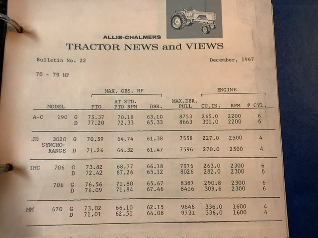

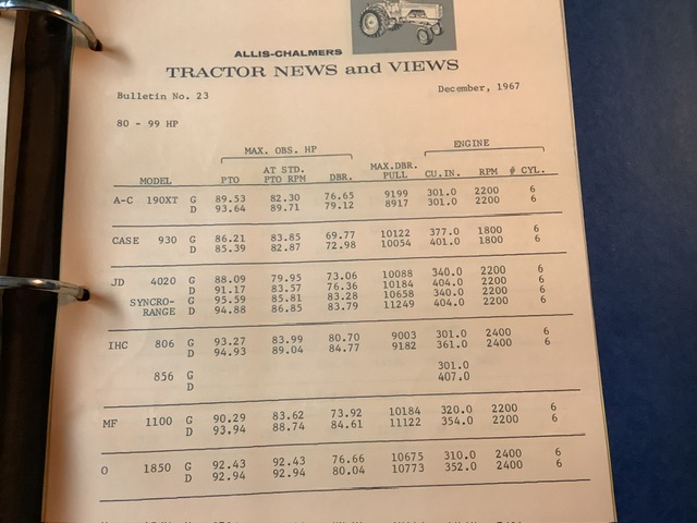

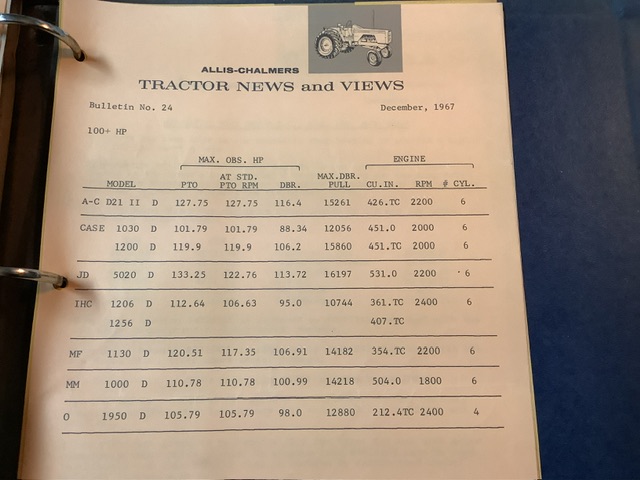

Thought I’d share these bulletins.
Hope you can read them

Mikez, thanks for posting your AC bulletin page photos. First time I’ve seen such AC literature for 1967. On the D21 II’s 426 engine displacement info, what does the “TC” mean ?

Turbo charged
