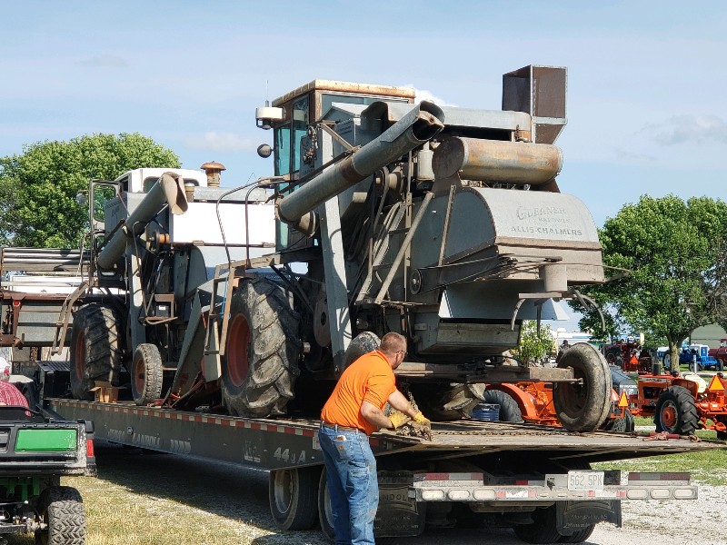

Hey everyone just been pondering an idea here and curious if anyone has anything like it. I've been doing more and more hay that is farther from home and the old allis tractors just aren't the quickest machines around. I was thinking if I had a trailer with tandem axles that would be just long enough for the tractor to be fully on the trailer but leave the back of the tractor right towards the end so the baler or rake could be left on the ground to trail behind it could be towed down the road with a pickup around 30mph. Which is double what any of my tractors will do (d14, d17 and 190xt.). I used to have a wc narrow front that was perfect for raking with because I had a little two wheel cart that would carry the front of the tractor and everything else just trailed behind. I really liked having the pickup at each field so if something broke I could just take the truck and go home for parts and tools. If anyone has something they use I'd love to see it.

Why not get a car dolly or whatever they are called. Drive your WFE oni it , tie down and take off. We use to pull a WD 45 between farms with a home made tow bar hitch. I'd guess at 30 mph. Te furthest were 19 miles apart. Never added balers, etc. to the back too. Just had more equipment at those farms or planned ahead and used the pickup ahead of need.

I thought about the car dolly just didn't know if it would be heavy enough for say the 190. And unfortunately Mack I don't have a good big trailer of my own to haul the tractors yet. I have to borrow the farms or my father in laws, and I was trying to get as compact as possible as done of these are small fields without much parking area

Do you think a car dolly is stout enough to move a tractor around safely?

and no a car dolly isn't heavy enough for a 190. a 190 is twice the weight of a car dolly tow rating. you'd still have tractor tires on the road and be speed limited by them.

From a technical standpoint, I would NOT flat-tow a tractor, or nose-tow it (back wheels on ground) at any speed substantially above what it would 'normally' operate at on it's own, for simple reason-  the gear reductions between axle and transmission would be spinning substantially faster than designed, and may fling off oil before being adequately lubricated.
