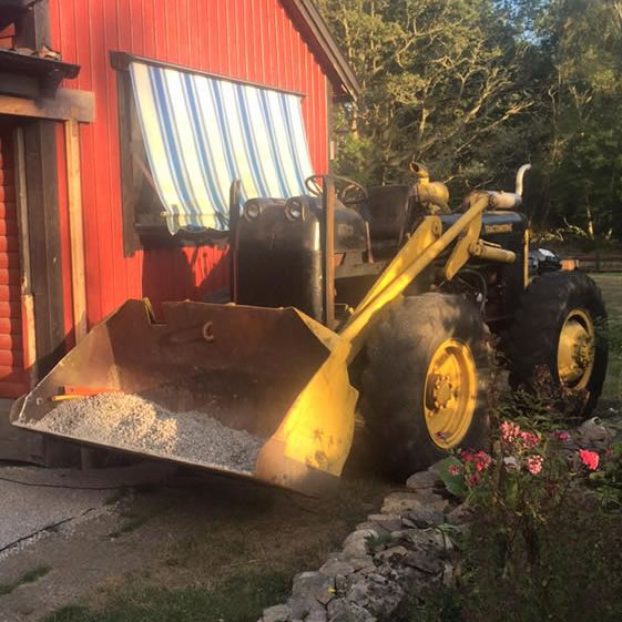

I have a Tractomotive TL-12D. It's in working condition except that it needs new friction discs in the transmission. Each clutch (forward/reverse) has 6 friction discs so the total amount is 12.
I have a local firm here in Sweden were i live that's ready to help me with the job but they need the original thickness of the friction discs. But I don't know that.
So this is a long shot. I'm hoping someone here has that knowledge or some old documentation from Tractomotive that could tell.
Tractomotive part number is 12202.
Love the machine so would really like to get this fixed. :)
