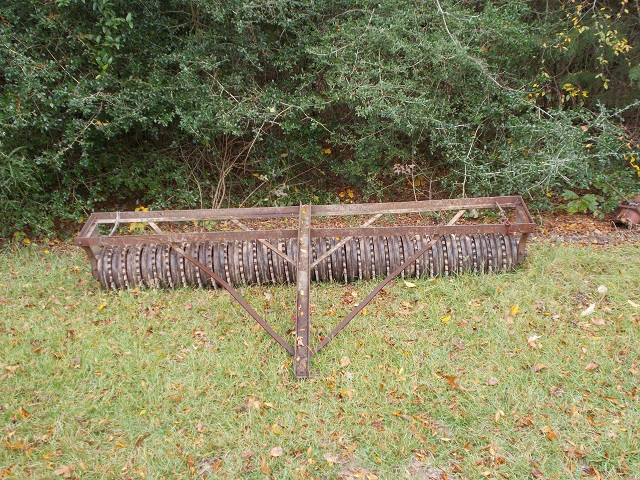

Old Fashion Cultipacker.  Add some weight and  use mine to roll track between pulls After blading.  Better than nothing

Post Options Post Options   Thanks (0) Thanks(0)   Quote Ken in Texas Quote  Post ReplyReply Direct Link To This Post Posted: 25 Nov 2018 at 2:32am
Sold my packer to a local farmer to use for its intended purpose.
