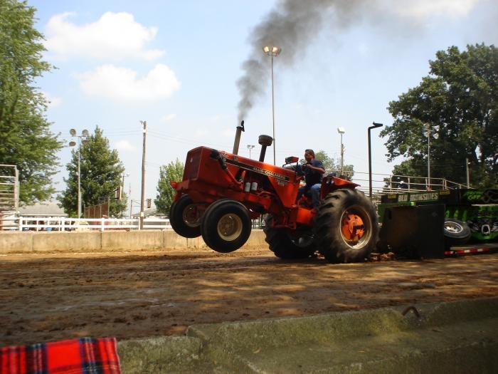

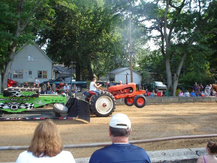

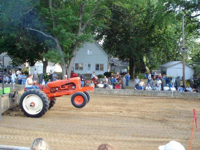

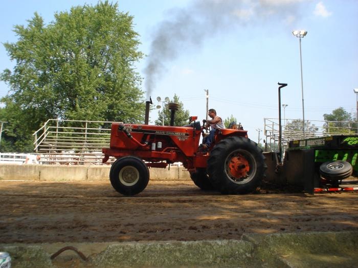

 These are the pictures of the WD-45 diesel that we pull, in classes 4500-6500.  We also pull the 185 in 7000 & 8000 pound classes. We won several 1st, 2nd, and 3rd places pulling last year.  These are tractors that I use to farm with.  It sure is fun to beat out the tractors that they only use for pulling!

whats all done to the 185 ?  how much horse ? and the long tube that sticks out the side ?
                         just asking   Shawn

We run 3000rpm in the pulls and the pump was worked on and 200 nozzles were put in. The tubing that  you see is hooked to a car intercooler along with a electric fan in front of the cooler. This is mainly done for farming as all I do to farm with it is to slow down the rpm. The extra tubing actually make me loose a couple of pounds of boost. We are running a little over 200hp.

   Huh, I think I'm in that third picture. Wish they would forget the stupid slow speed limits down there.
