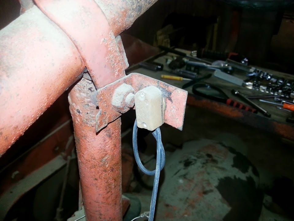

Question for the group...  Through some of the links you folks have posted on here I've fallen into a rabbit hole or two (Tongue), but one of the links (and I can't remember which one) took me to a site where it was mentioned that some of the older B's didn't come with any wiring at all, other than the spark plug wires.  This same article/website is where I learned that the little tab on the side of the magneto was actually a grounding strap, if you will, and that's how you shut the tractor off.  Neat!
On my B, I've got a two-position switch on the steering shaft support, see below:
As you can see, one of the wires loops back on itself and is attached to the switch mount, which I'm assuming is part of the grounding circuit for the switch.  The other wires runs down to the mag, as you can see below:
When connected to the grounding strap on the mag, this would make your "kill" circuit, if you will...  My question is what does this harness really look like on a B that has this type of switch??  How was the wiring run down the tractor?  Or, as I'm suspecting, is this a home-made kill switch??
As always, any info would be appreciated and thanks for your time!
Eagle
Points: 12071
Post Options Post Options   Thanks (0) Thanks(0)   Quote Steve in NJ Quote  Post ReplyReply Direct Link To This Post Posted: 22 Aug 2013 at 8:02pm
The real early B models were crank start. Most didn't have provision on the block for a Generator to mount. (BE engines) Those particular units didn't have lights either so there was no need for a Gennie. As time progressed, so did the B, and lights, Generator, and electric start were added. The B/C blocks had bosses to mount a Generator. As those accessories were added, of coarse so was a wiring harness. On B models that were equipped with lights, a Battery box was added between the tool boxl and the steering column support post. Its at this post an instrument panel or Ammeter panel was mounted housing the Ammeter, three pos. charging switch, and Mag kill switch. That particular switch that's on your Tractor someone added on. Moving the mag kill switch near the driver is much safer should something happen where you would need to shut the engine down quickly.  HTH

The tractor that you have didn't have that, or any, switch to kill the engine, as Steve mentioned. The throttle quadrant linkage was set up so when you pulled the lever all the way back, the engine would shut off so there wasn't any need for wires and a kill switch. Bob

Yeah Steve, it does, so thanks for that!  I've seen the battery box along with the other controls/switches in my manuals, so I know I've got something "a little different"...  Seems like Grandpappy was a bit of a tinker-er, if you will?? Smile  Or, he may have bought it this way??
As you mention, for safety reasons, I'll keep the switch and clean up the wiring...  Maybe run it in some type of small wire loom or something??

Now that's something I didn't know!  Great info, appreciated!!  I'll certainly check that functionality out when I get it running, but I'll also keep the switch just in case...

EagleTDL,  You have received some excellent input from our renowned electrical expert SteveNJ.
The early B tractors that I remember did not - as Steve Says - have any electrical wiring with the exception of the plug wires.  In fact, to my recollection there was a kill clip mounted on the mag to stop the tractor.  I was not aware of the feature whereby one could move the throttle beyond the running position to kill the engine.  I remember I would move to the side of the B and push the kill clip.
Later, as you have seen, since nobody wanted to get off the tractor some rigged an off switch such as yours so they did not have to get off the tractor to stop the engine.  In fact they usually stopped them on an incline so they could be moved forward to turn the engine without having to crank it.
Charlie, I do not remember any B tractors coming through with the WICO mags as original equipment.
Take good care of my favorite.  You have a collector's tractor.
During WWII a few B tractors were made without electrics to save the copper for the war effort.  The starter hole in the torque tube was plugged with a cover and there was a small triangle tin to fill the gap where the tool box was cut for the battery box.  The bosses for the battery and generator were there but not used.  After the war when these items were readily available they were usually added and the plug and the triangle were junked.  Finding one of these would be very significant.

My 38 B has a toggle switch on top of the toolbox. The wire goes thru the toolbox and out along the right side of the block.

I think that will be my option Mr Tuck...  Glad to know I won't be the only one running a similiar setup!  All future questions will come to you... LOL

Hello, I have been working on my Dad's old 48 C after inheriting it three years ago. It was pretty much apart, but Dad had rebuilt the engine probably 20 years ago.
I purchased a wiring harness from Steiner tractor and had decided it was time to get the old girl moving. I actually drove it up and parked this morning!
My question, related to this thread is that the ground on the mag does not kill the motor when it is running. You can push the ground tab on the mag, or ground the wire, nothing, it just keeps on running.
Can someone help me with this please?

I would guess that the wire is not connected inside the mag, so it's not getting shorted out to kill the fire.

I'm wit' Tuck on that one. There's an insulated wire that is connected to the inside of the screw that comes out to hold the shut-down tang in place. That insulated wire runs under the front of the coil inside the unit and up to the points. Doesn't sound like its there or connected as Tuck mentioned. No wire... no shut off.....Might havta' pull the choke closed to shut down the engine till ya git' the wire connected.   HTH
