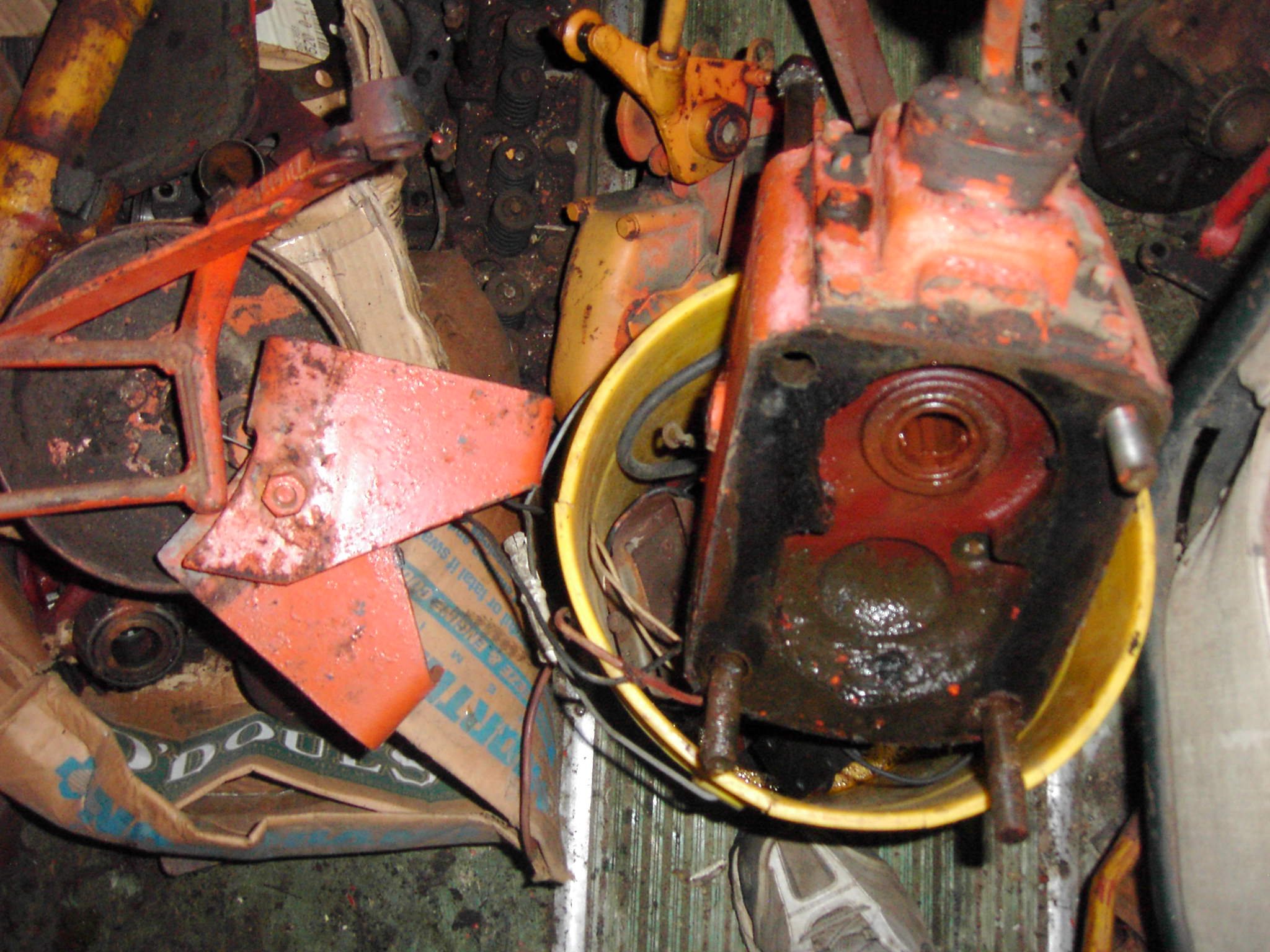

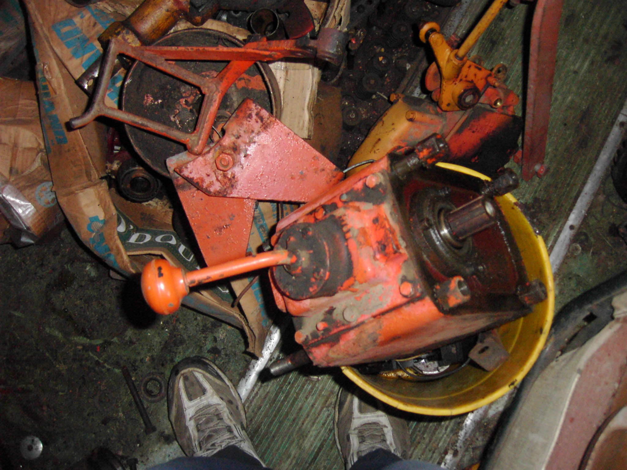

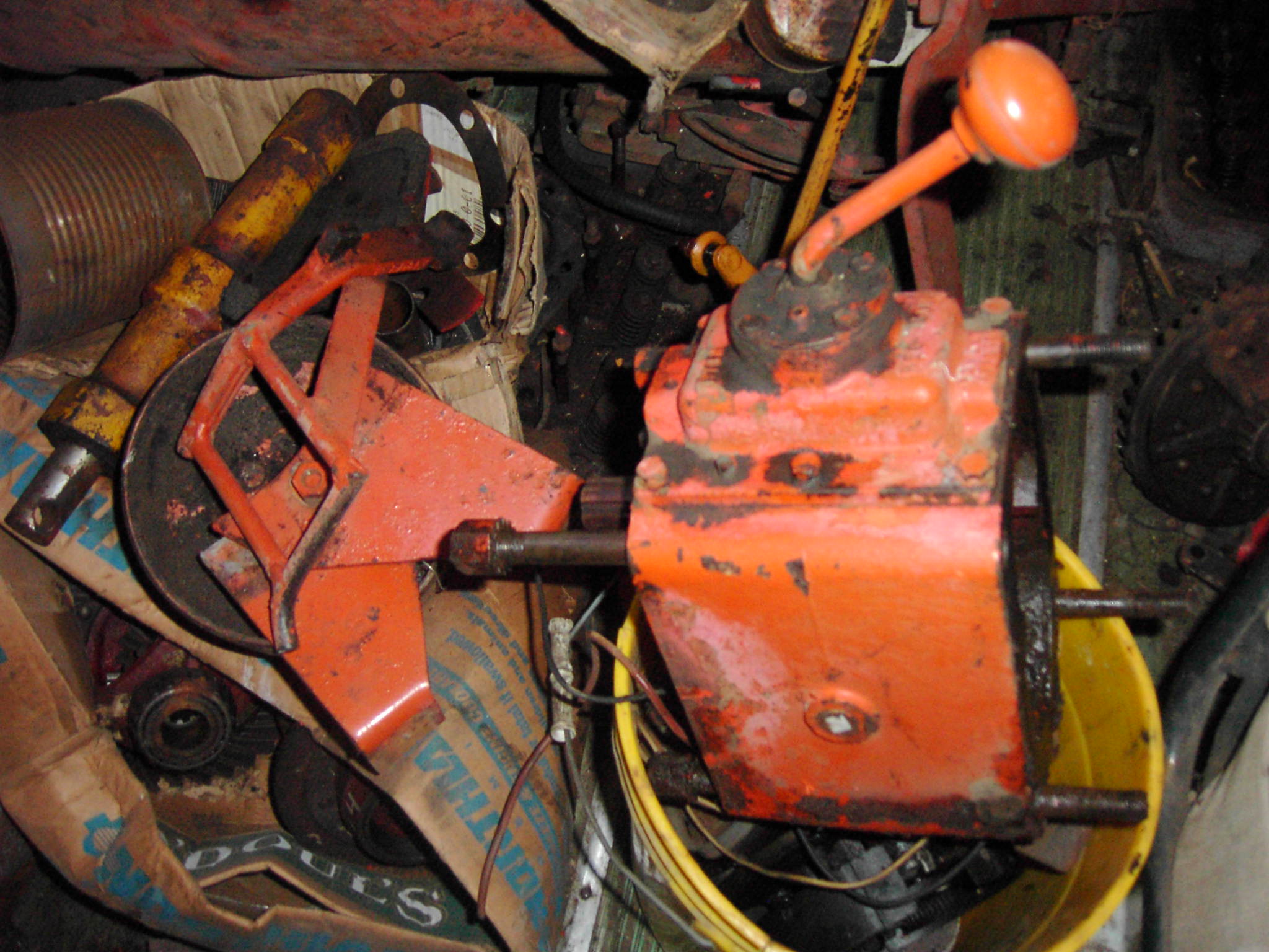

Here is one on a CA that I had.

Here's another version
