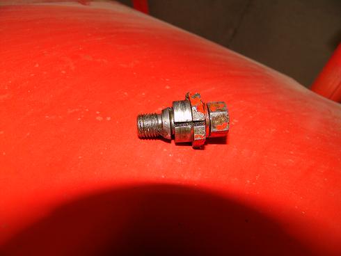

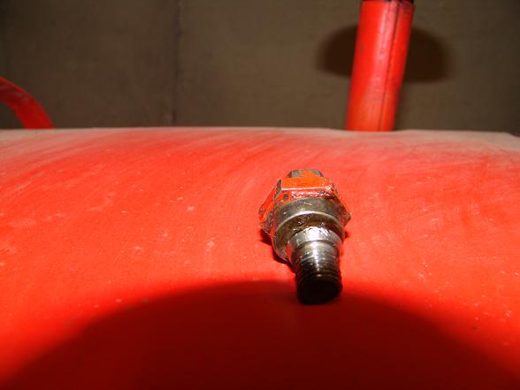

My dad has a 1941 Allis Chalmers Model C, It has been in the family for many years. He is doing some work on the steering box and needs to replace a bolt. Anybody know what this bolt is called and where to purchase this part???
Jeff Z. NY View Drop Down
Points: 7326
Post Options Post Options   Thanks (0) Thanks(0)   Quote Jeff  Z.  NY Quote  Post ReplyReply Direct Link To This Post Posted: 11 Sep 2011 at 8:24pm
I think it's called an eccentric sleeve and I would say you will probably have to find a used steering box to get another one.

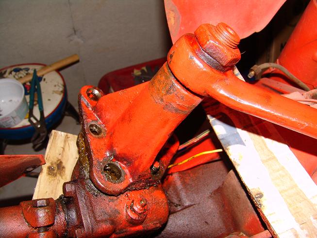

Do you have any tractor graveyards around your area? Where is your area? Somebody on here is probably close. Looks like you have the early style Gemmer box rather than the Ross box.
