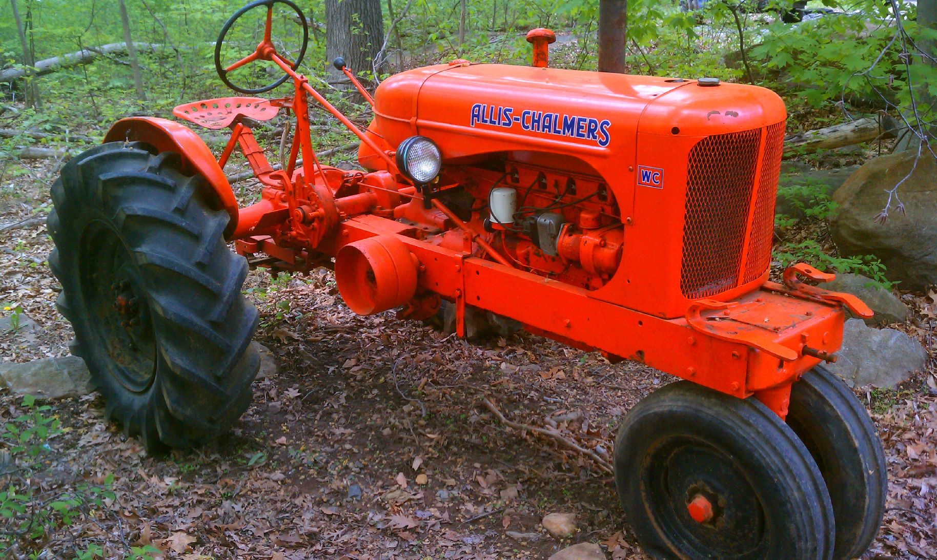

Hello,
I have a 39 WC that does not have the typical Rear rim that most WC's have. Why did Allis Chalmers make the solid drop rim for 39?  Did they make it for any other years?
Thanks,
acisbest

They used them on WC's from serial #59636-81757, so late 1937 thru late 1939 and also on WF's in those years. I'm guessing it was just an improvement from the spokes until the 2 piece came along.
