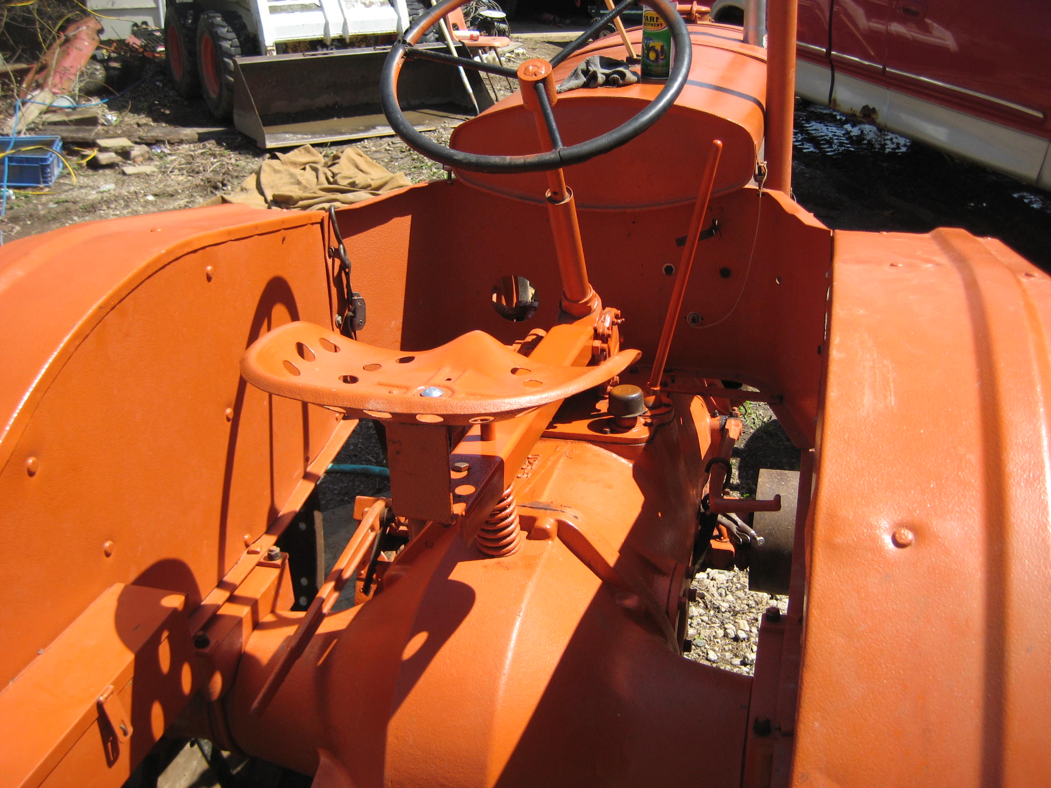

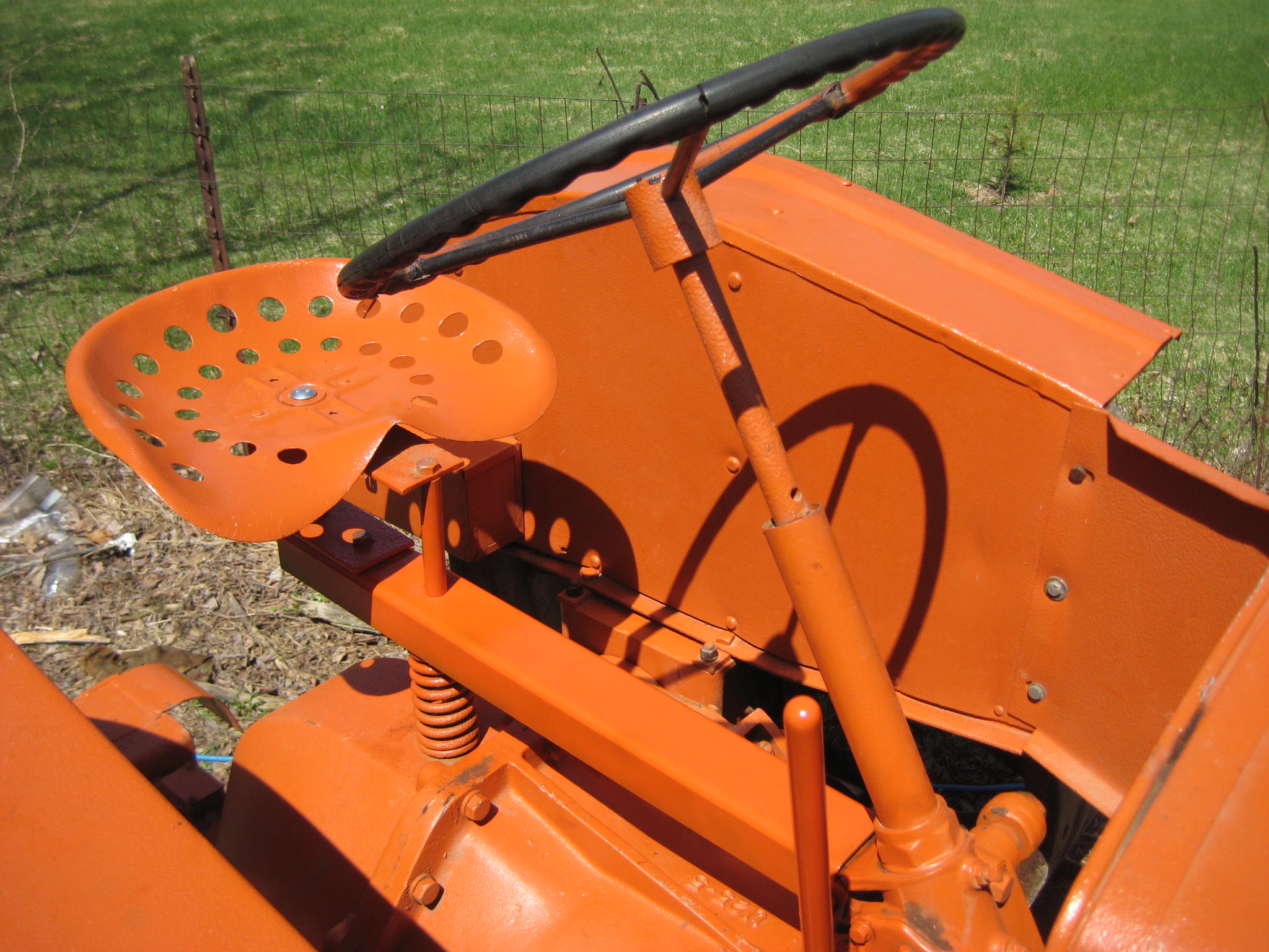

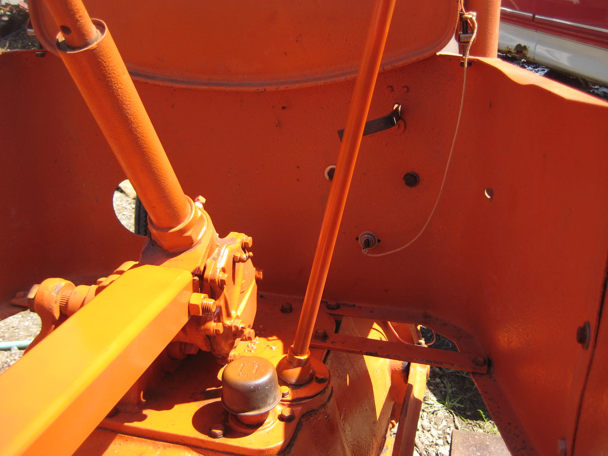

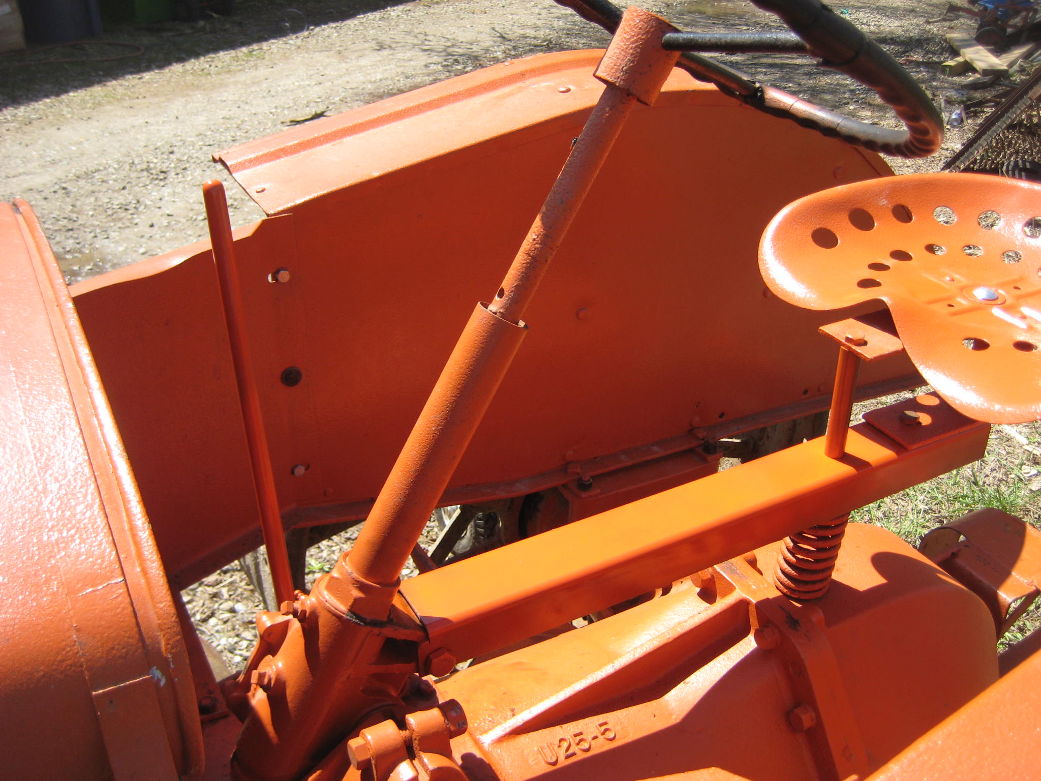

Post Options Post Options   Thanks (0) Thanks(0)   Quote zootownjeepguy Quote  Post ReplyReply Direct Link To This Post Posted: 23 Apr 2011 at 1:27pm
Okay, this is what I have. I reproduced the seat channel as close as I could to the original(?) worn-out channel that was on the tractor. The shift lever is also new but I need to cut it to the correct length and add the ball (once I find out what size ball should be on it). Both of these assemblies have been squirted with rattle can paint just to help keep them from rusting until I get around to restoring the tractor.
Is this what it's supposed to look like? I mean there is no "floor" and I don't see any signs of there ever being a floor on this tractor. I am also wondering if my seat assembly is correct? I would imagine that the channel and spring are right but I'm wondering about the extension between the seat and channel, looks like it could be home-made. I'm open to comments!

That seat and high steering assembly is correct on your tractor jeepguy.  I have the same set up on my continental U.  I also have a foot clutch and floor pan set up on mine that was on another one I bought for parts and I decided to use it because it looks so nice and clean.  That seat riser on yours is exactly what mine looks like, it was to raise the seat up more along with the longer steering shaft into the steering gear box.  Mine also has a tube around the steering shaft all the way from the bottom of the steering wheel to the top of the steering box.  I'll get some pictures for ya, when I have some time.

Here's some pictures I just took of mine out in the shop.  Don't mind the dust, been alot of activity out there this winter and I haven't had her out to get a spring clean up yet....lol  As for my shifter height, I just found a spot where it felt comfortable for me and made mine the appropriate height, I have no idea how long the original is supposed to be as I have never found any information in any of my manuals or parts lists showing the exact height.  I know the ones without the higher seat and steering column were lower, I just made mine a height that was as comfortable as possible from the higher seat.  My suggestion is that you do the same.

That picture shows the basic set up, which was what I was referring to above as the "shorter seat and steering column".  That's how I've seen most of them as being.  But, like mine, there are a few out there with a seat spacer, taller steering shaft and taller gear shift.

 I think I'll keep the shifter at the current altitude and maybe add the ball later. Obviously my steering wheel is not correct and, unfortunately, it has been welded to the shaft (I'll end up machining a new steering shaft too). The steering tube appears to be two pieces on the tall steering version. I see that my tractor has the extension missing from the steering tube.
