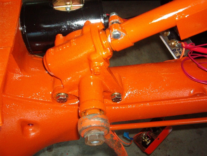

I have taken several apart that this bearing in the botton was rusted to the point it was almost gone. Tok both hands to turn the steering wheel.
This cross shaft was rusted in the places shown and even though the pawl was in good shape the steering was very hard to turn. The bottom bearing race was rusted real bad and fell apart when removed from this Ross B steering box. The cross shaft was also hard to remove becaues of the rust in the bushing area. rain water can run down the shaft on these and enter the steering box thru the top bearing.

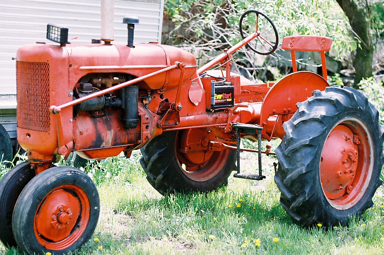

here is the b iam working on I took light off and I need to fix the seat  but it seems pretty complete I am starting a garden this spring and looking for a small plow save $ on food this year maybe?

I hate to burst your bubble but that there B ina picture am a C.

That's not a B, it's a C.

well this is good to know dad always said b but things he said were iffy at the end ,but maybe he confused the old deere b he actually cried when he sold it . dous my ''C'' seem to be a 46 and how can I tell? and whats the differnce between b & c

The B is a one row tractor and a C is a two row tractor. The serial number should be stamped on the torque tube by the shifter. It should start with a C (If the tractor was a B it would start with a B) There is a database on this site that will tell you the year by the serial number. On a side note I actually find the C's easier to get on than a B.

Quick easy way to tell is to look at the drawbard. The C has the wider drawbar.
