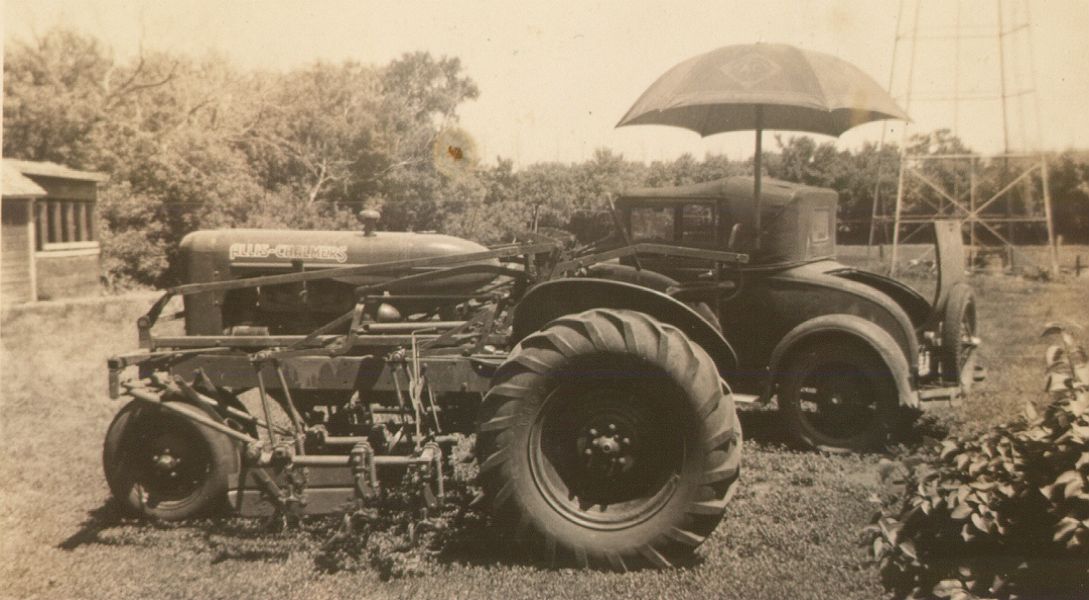

Yes some came that way, here is a picture of one.

That one must be a late 1938 or early 1939 from the wheels.
