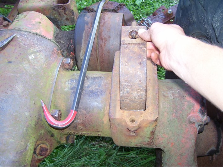

You have to pull one end of the band out so that the whole thing rotates around the brake drum. The bottom pivot pin is usually rusted and there's always a bunch of mouse nest material/grease/dirt, so it takes a bit of patience. Clean as much of that junk as you can out of the hole underneath the brake housing and try to pull and rotate it out from the top. I've found a pry bar is very helpful. So far all of the bands I've pulled out have needed complete replacement, but hopefully yours isn't so bad.
Maybe this photo will explain it better.

You have to take the fender and the brace piece off of the tractor before you can get at the brakes.   By the sound of your post, I think you just took the brake cover off.   It needs to look like wjohn's picture before you can get them out.  I do agree that most of the time, the hinged part on the bottom is rusted and junk so the only way to do it right is to replace the entire brake band.
