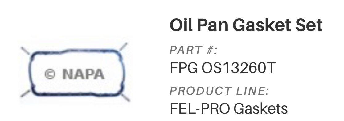

Post Options Post Options   Thanks (0) Thanks(0)   Quote jboettcher Quote  Post ReplyReply Direct Link To This Post Posted: 28 Apr 2019 at 10:51am
It appears FelPro makes a 1-piece neoprene gasket for a WD.
Does anyone know anything about this item?

Anyone ever try one of those one piece gaskets?  Looks interesting.

Put one in a big block Chevy three or four years ago. So far so good. I did this in chassis so a four piece set would have been a nightmare. No experience with the WD set.

Update.   I fixed a leaking oil pan on my WD without a gasket.   I used Right Stuff from Permatex.
I went to a engine machine shop and told them what I was doing, and they suggested Right Stuff.
It’s very heavy bodied and you need to work quick. I let it set up overnight and I’ve run in an hour so far with no drips.
(And I wasn’t chasing 4 pieces of cork around)
Just a heads up, it makes life easy
