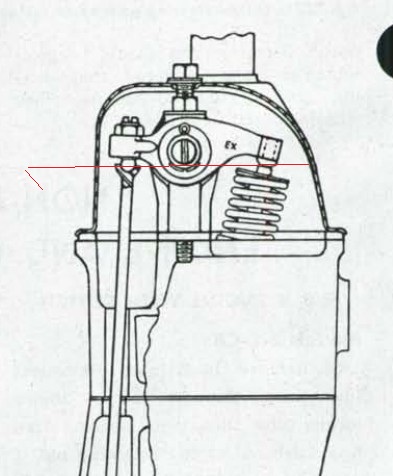

Post Options Post Options   Thanks (0) Thanks(0)   Quote steve(ill) Quote  Post ReplyReply Direct Link To This Post Posted: 15 hours 29 minutes ago at 12:56pm
here is a drawing from the "B" service manual.. Shows the rocker arm setting about horizontal.... You should visually be able to tell of your rocker is too far toward the pushrod or too far toward the valve... That would tell you which side the problem is on... assuming your adjusting screws are proper length to have the ball sticking out on the bottom and the nut installed on the top...

Post Options Post Options   Thanks (0) Thanks(0)   Quote steve(ill) Quote  Post ReplyReply Direct Link To This Post Posted: 8 hours 30 minutes ago at 7:55pm
look at the drawing above... is the HEIGHT of the PUSH ROD above the head ( valve cover face)  about the same as the height of the valve SPRING above the head  ???
