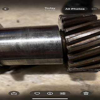

Should there be this much of a gap between the crank gear and the journal in the pic?

A good machine shop will cut the counter bore the same amount when decking. The gear is to be tight against the journal.

.040 end shake is not abnormal when taking apart a WORN ENGINE....end shake should be more like .003 - .005 inch... You put in the new bearings and see what you get.. If you have to reduce the clearance, you can pull the gear back off and machine a step on the end so it pushes on a few thousandths more.

So the space between the gear and the journal should not be there and mine has walked out. Is it just a matter of the machine shop pressing the gear back against the journal to bring it back to the proper end play?

I should add- the space between the gear and the journal is .060

I guess another question is if the gear is pressed all the way to the journal does it even act as a thrust surface or not?

yes, that is the THRUST surface.... originally the gear was pressed on flush against the journal.. That was suppose to give you "about" the right backlash.... Now the tractor is 70 years old and who knows what is worn in that area.. Like i said, push the gear on all the way and see how it fits on the journal.. If too tight, pull the gear and put a shim behind it.. normally they will be too LOOSED, and you pull the gear and  under cut a step on the back of the gear so it will move inward .020 - .040 or the required amount... to get a few thous backlash.

I see what you're saying now, thanks Steve. Thanks to all the responses as well!
