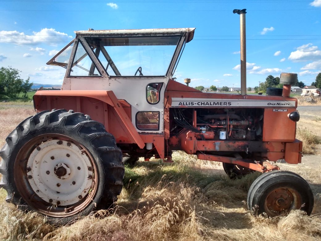

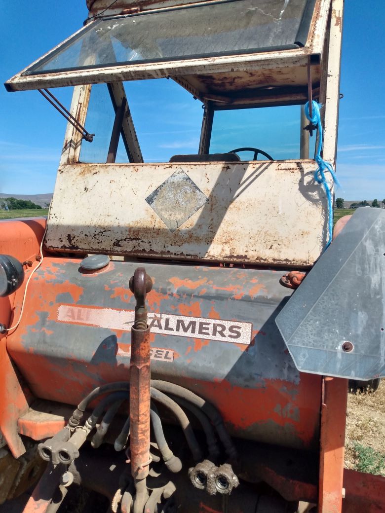

This tractor is the one that made me realize I visited this forum a lot and should just join. I was trying to figure out what the cab was, it took a while to sink in that homemade is the correct answer. I have the water pump changed, and after cleaning a little around the front of the engine I found that tha front main leaks a lot. Not a lot of time or shop space to work on it now, so I'll try to pick and choose small fields to run it a bit this summer to see if other things might need repair. Couple of worrying things - it needs starting fluid to start. Bought it in January, expected it then and it started right off after the hour ride home. In June i would expect it to start, but not even smoke until the starting fluid. It doesn't seem to have blowby, so it may have been from sitting. It also starts to sound like the engine is working after running fifteen minutes or so, slows down a little and changes pitch, this while running about 1000rpm. Again, probably things that will either make the problem known or go away as I run it and get used to it.

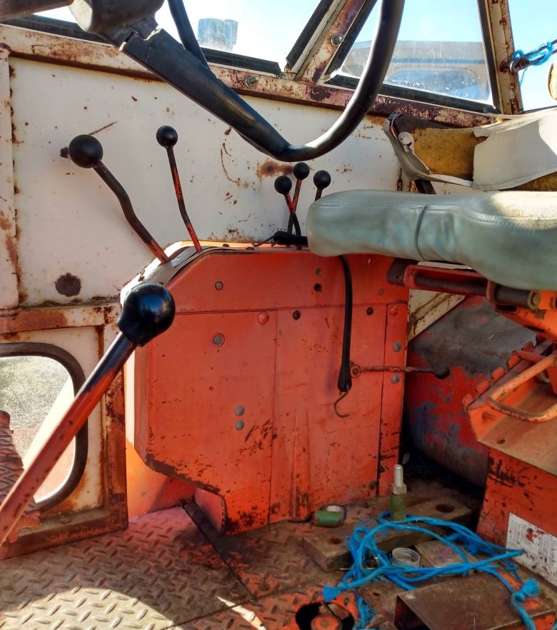

If you look you can see that whoever put the cab on also had to move most of the controls. Future plans are get the correct batteries in the correct place, get the wheels turned back around, clean up the wiring, and see what else I need to do this winter.

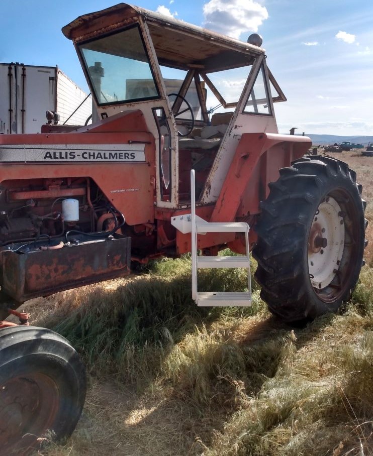

I addded those, it had an angle iron bolted to the side of the battery box near the bottom. I still need to add a brace to the battery box. They are a replacement/ update that I was going to put on my JD4430, but after using them a bit on this I'm not sure how much of an update they are. Easier to get in and out of this one now, but in comparison the 7000 is easier to get in and out.

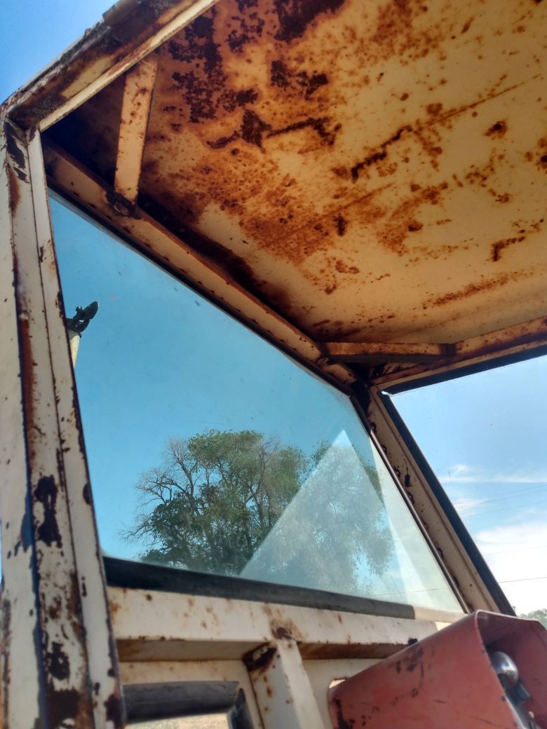

That cab took a lot of time and effort.  Those odd shaped windows are a curiosity to me.  That guy was proud of that I am sure.  No windshield wiper but with that extreme angle may not be necessary.  At first I thought the roof was off of Laporte Cab but then maybe not.  I guess it never had a door.

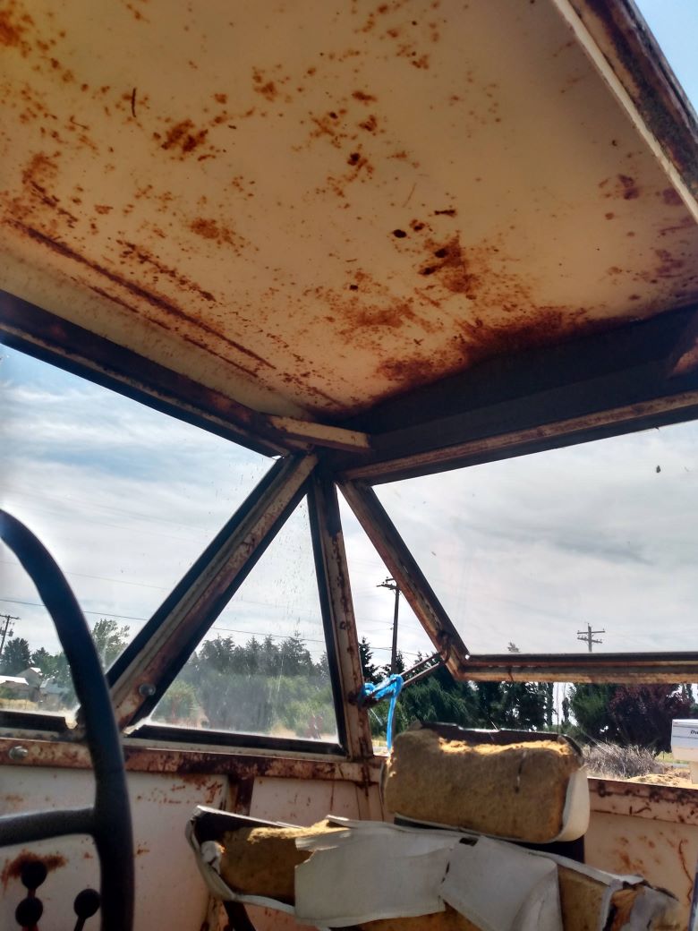

calico, you are right about that cab being a lot of effort, every corner in it is gusseted, upper and lower. And it does have half hinges arond the back and top of the door, not sure gravity would be your friend if there were a door mounted on them. The roof has a ridge running the length of it, so entirely possible it is from a donor cab.

And yes,this one has 15.x38 rears. My other running 190XT has 14.9x38s, it had 12.4x38s when I bought it. The only other two 190XTs that I have seen have 18.4x34s, thought it was odd that mine had 38s. I came to the conclusion last year that someone had put 7000 wheels on it(don't know if that is possible, never looked into it) and then I found this one. I also stumbled across a D17D series IV a couple months ago that has 13.6x38 rears, so I'm starting to think it must have been an option.

TedN, welcome to the AC forum & thanks for sharing your latest 190xt’s photo. It’s cab design may have some merits for central Washington state’s semi-arid climate?
It’s “Forward roof” could offers more sun visor duration comfort for operator during mornings & late afternoons?
Also field soil dust would most likely shed itself more easily from that heavily slanted windshield glass, especially if engine radiator fan was pushing air back onto it?
When operator stood up from seat to exit that cab, they’d most likely been bent forward & so that cabs extra forward space might have offered more head room while exiting cab?
The rear fuel tank can sometimes block drawbar view? Operator would sometimes need to lean back to see over fuel tank, so it’s hinged rear window probably opened to offer operator a better views when backing up to & hooking up to implements?
Cab’s roof/ ceiling height is much shorter as compared to engine’s hot exhaust pipe gasses & noise, which may deflect sounds & heat away from operator?    Same sound deflection from engine noise might apply to its slanted windshield glass?
The windshield section of that cab resembles early gleaner cabs (1964-1975?) winshield? That would coincide with a Series I or II XT timeframe?

I had the day off work so I was able to get a few more pictures of the cab.

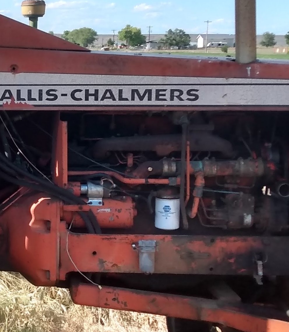

I started it again and paid a little more attention. About the time I start to get worried about starter temperature it speeds up a little and makes a little smoke. I might have eventually got it to go, but just gave it another small shot of ether. Once it fires it is running, no stumble or build up to speed and not enough blowby to notice. I looked at my other 190XT with the bad engine because I am thinking about pulling the pump and injectors from it and get them checked out to replace what is on this one, and I noticed the hand primer. The series I is missing it, and just has a rubber hose in it's place. I know there are check valves in the primer, could this be why it doesn't want to start? Agco still sells the pump new, the tube from the primer to the filter is on backorder, and the fittings may be a little more fun to find.

looks like someone had an electric pump on the frame rail. While the primer has check valves, if tank is full enough, it should not drain back with the gravity tank these have, unless there is something leaking it out. Using the spare pump from another tractor is a good idea, as long as it's compatible. There's several different pumps that were used on 190XT. All very similar though, but minor differences.
