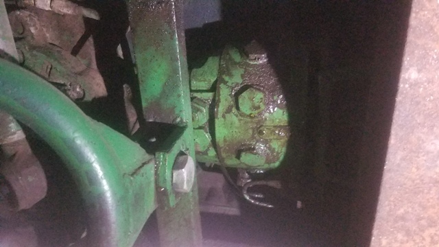

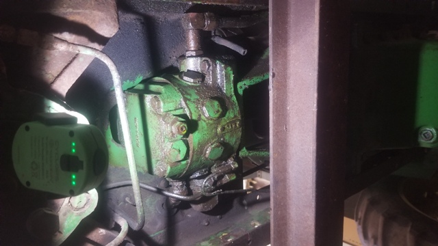

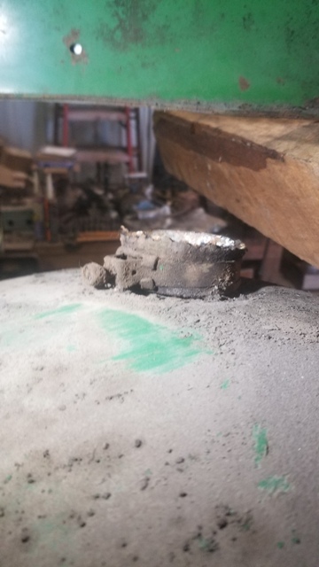

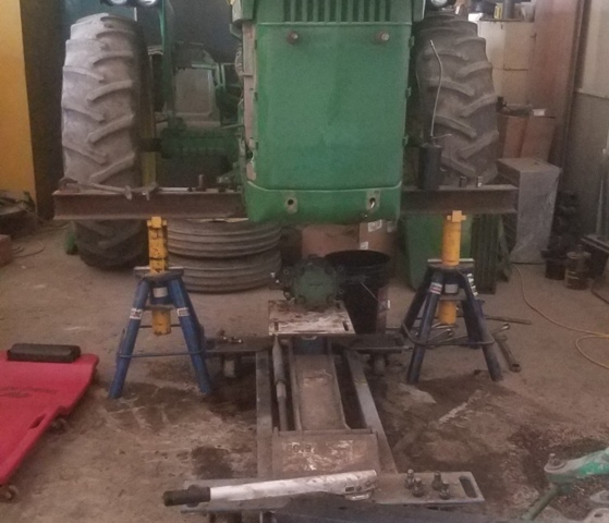

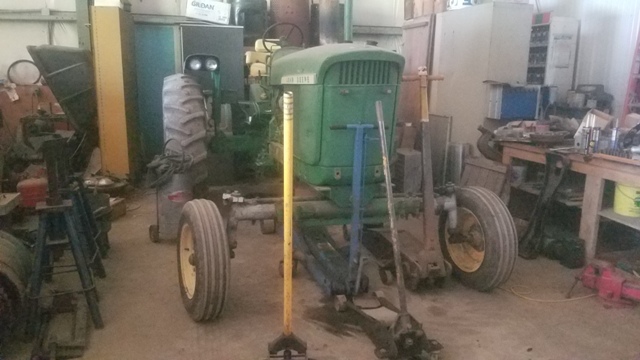

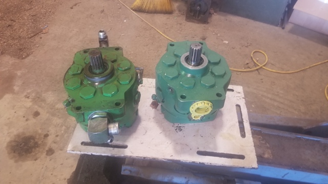

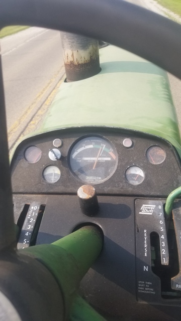

3020 Deere. Really good condition but main hydraulic pump has taken to seeping. Works fine but is needing resealed. Owner purchased a brand new one as doesn't want to have problems later on as tractor is a working unit. Multi year loyal customer so I won't tell the family "No" to any work they need. Pays well too in cash at job completion:

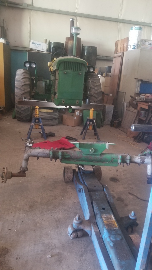

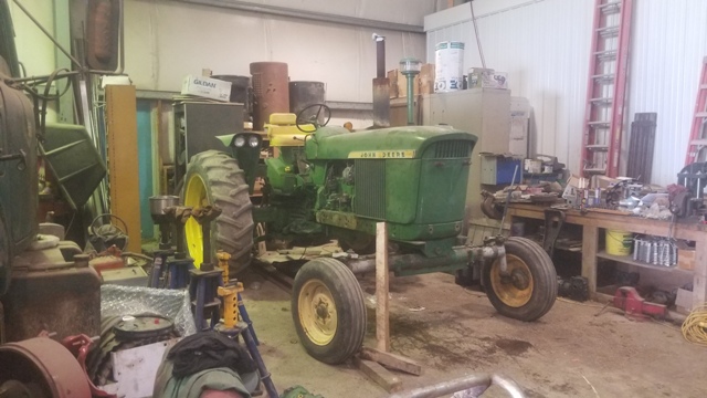

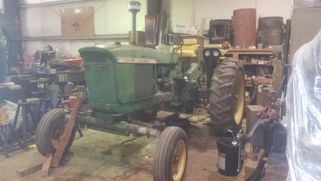

Parking spot in the shop:

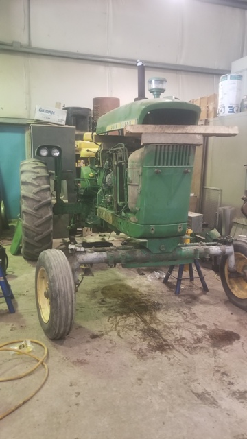

Steer axle removed for clearance:
Leaker:

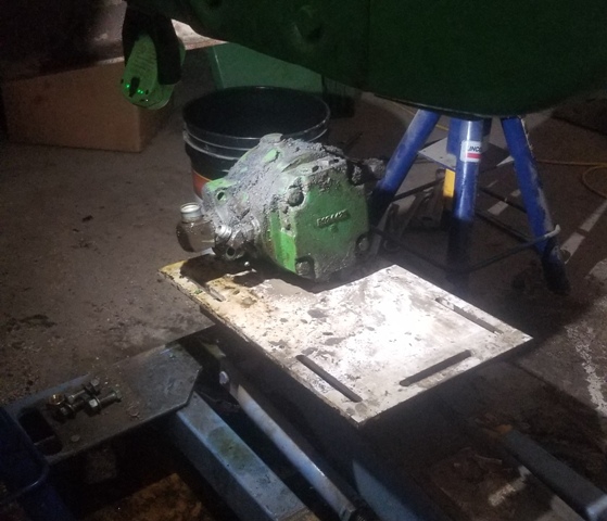

Damned pump is heavy so used transmission jack to remove it from the tractor:

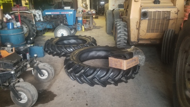

Owner ordered brand new rear tires and tubes and they will arrive at the shop this afternoon. Old dry rotted and cracked originals are full of calcium so I'll need to see if that gets replaced or not. I'll blast the rims clean and paint them up before remounting the new tires.
This job will partially fund other projects going on around the "hood".
That's All Folks!

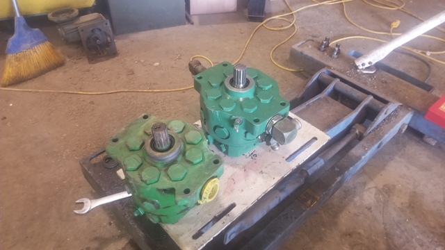

New pump matches old near exact and is Deere supplied. Old pump on left fresh from solvent tank:
After moving fittings over with new sealing rings:
Fasteners are in solvent tank degreasing so will slip it back together after lunch and wrap the job tomorrow morning. Greasy slimeball on the underside, (oh wait, that's meWink) as the front seal really started leaking and throwing last year during harvest; or the story goes:
That's All Folks!

If that new pump has a serial number plate, you’ll need to time it to the engine to prevent vibration in the hydraulic system. Outer dimple on the pump shaft goes in the 1:00 position when engine is at TDC.
Thank you, I've never heard that in the past. Both the old, and new pump have holes, or marks on the input shaft. I didn't know what they were for but was planning to align the new to the old before slipping the unit together. The engine has not been rotated but I will ensure the engine is on TDC now knowing.
Thanks again.

Brand new pump supplied through Deere. I'm asked to not reveal price as a personal relationship is at play, but it is close to a reman unit in the aftermarket.
As prior poster mentioned, timing is important and I'm grateful this was brought up. The pump is shipped in the one o'clock position in the box so will align the crankshaft timing marks to correlate and slip it together tomorrow sometime.

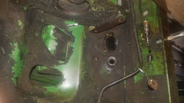

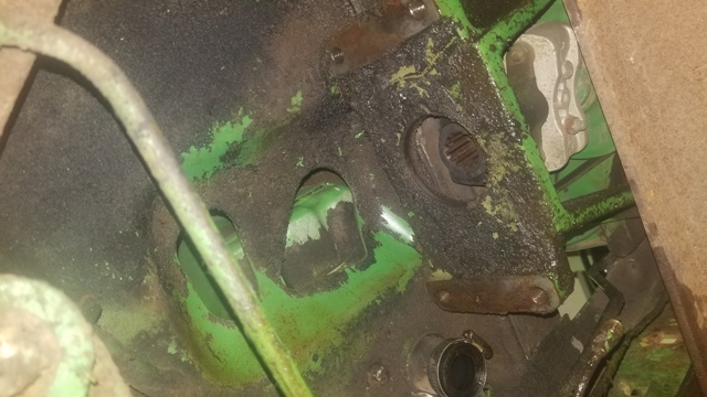

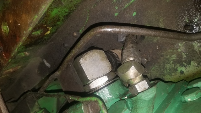

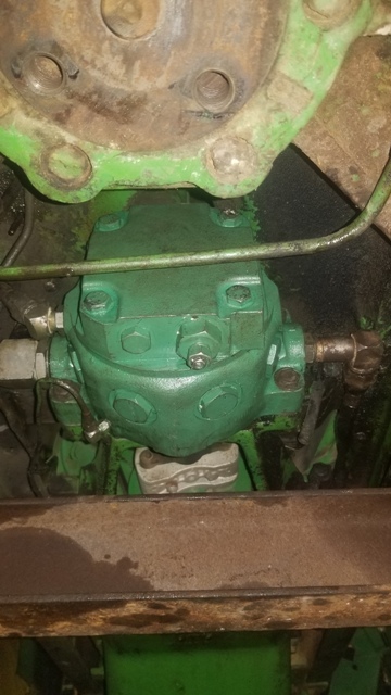

Pump slipped right in late last week, (timed correctly) and buttoned up as far as connections. I found the coupling hose for the fuel filler neck parted, (original) and the main suction hose between the oil cooler and pump inlet to be cracking and aged so am replacing via the local Deere dealer. Radiator hoses are being renewed also. Oil cooler was partially restricted so removed the same and going to pressure was it clean. No real way to get straight to it while in the tractor.
Also replacing the transmission oil and filters as several years aged in the tractor. Have two fresh five gallon pails of the Deere fluid specified by the dealership. Owner dropped off two brand new drive tires and three tubes and will have them filled with "beet juice".
Pump installed:
New cruising tires:

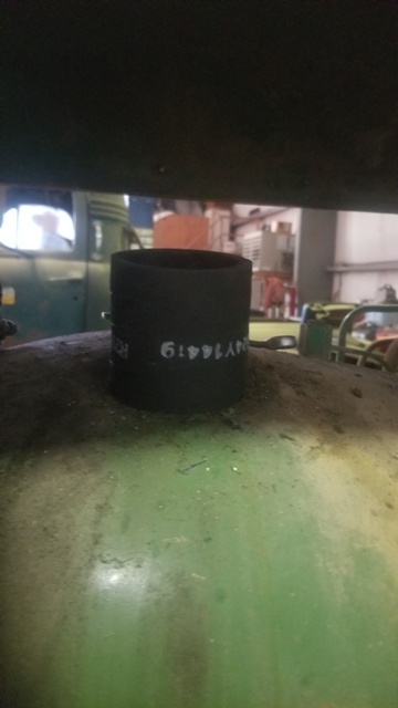

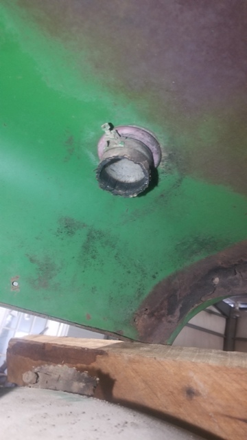

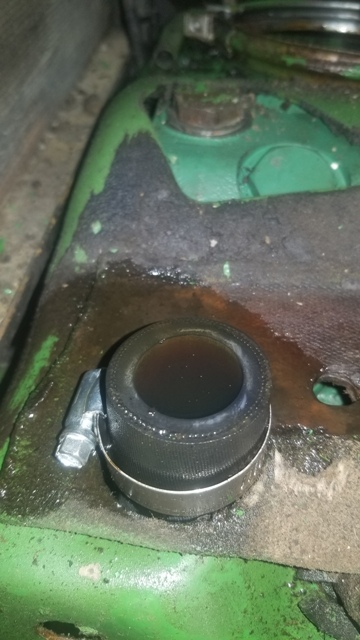

Fuel filler hose on bottom of hood panel:
Other end of hose on fuel tank:

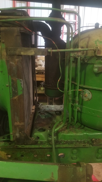

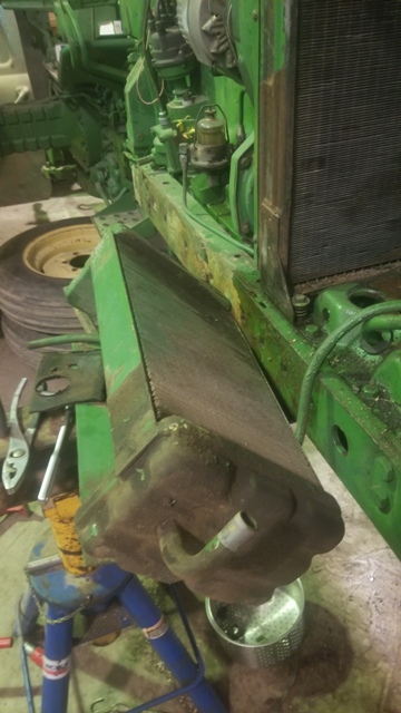

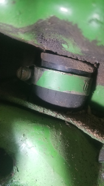

Oil cooler outlet, hydraulic pump inlet coupling hose:

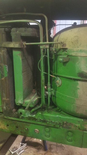

Oil cooler before removal:
Oil cooler removed:
New section of fuel filler hose. I'm awaiting the oil cooler discharge hose into the pump and should have Thursday. Strange size and I don't do "Fitz All" repairs if correct parts are available:

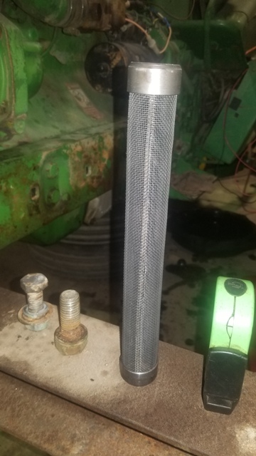

Did you clean the transmission pump pickup screen too?

I have not at this time. Only drained the sump. I will have a book on the tractor tomorrow and that will guide me much better as I've never worked on one of these in the past. I did circulate the drain oil through my filter cart and plan to reutilize it as a flush prior to installing new oil. There really wasn't anything wrong with the former pump but a leaking front seal causing it to seep oil. Unless cost prohibitive to replace oil with a hydraulic pump change, I tend to do this operation as a precaution.

Any time you drain the hyd/trans oil on a Deere(10-60 series), you’ll want to check the trans pump pickup screen. It can save you a lot of trouble in the future. There’s a plug in front of the LH final drive. Takes a 1/2 inch drive ratchet.

Thanks kindly. Never seeing one of these in the past lead me to order a correct manual for it. I figured being a power shift unit there had to be screens and/or filters for service.
I should receive some coupling hose and the manual today and possibly get the tractor back operational by the weekend. Hopefully the loader frame goes back on as easily as it removed.

Picked up the needed hose section, transmission filters, gasoline filter, air filter element(s), and two pails of the Hy-Gard transmission fluid. Owner has engine oil filters and I have bulk engine oil at the shop. Hopefully good to go in reassembly now. Still need to pick up a couple of hose clamps as the originals were not the worm drive types but rather the type where a machine screw locks them in place, (original).
Dealer had both the nylon screen, and stainless steel screens in stock should the original be compromised in any way. Not yet removed so no idea to original. Neither had magnets installed so no reason to believe original does.

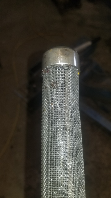

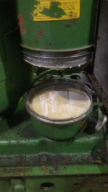

Pretty fair progress in the few short hours worked. Oil bath air cleaner was a milkshake of water and almost softened creme cheese shown here:

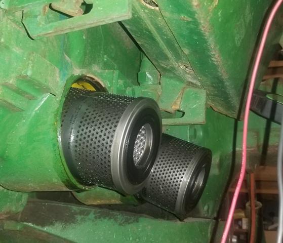

Transmission screen was incredibly clean and free from debris shown here:
Same screen after cleaning:

3020 gas power shift tractors were a bit starved for power. If I remember correctly the upshift from 6th gear was the worst jump.

I did drive this tractor just a bit before bringing it in for this work. The carburetor required a rebuild so was very sluggish on power. The main jet was almost totally restricted with this ethanol based crap we have to burn. That jump from 5th to 6th, 6th to 7th, and 7th to 8th was indeed awful steep. Once the rpm's came back up it had pretty good road manners as I was traveling at a pretty good clip by then.

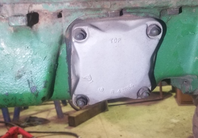

Finally located the second drain plug in the bottom of the transmission casting. With the screen out and a finger stuck into the opening hole there was still about an inch or so of fluid depth so something had to be missed. Found the second drain plug on the other side of the tractor restricted in oil/dirt mixture and untll cleaned, was hidden from view. Anyways, almost an additional gallon drainedhere. I ran a borescope into the openings and everything is very clean internally. A swipe with a finger yielded nothing unexpected so this tractor obviously has been cared for well.
I did glue a disc magnet to the lowest drain plug, and a strip magnet to the screen. These should suffice to capture any ferrous burnishings, (or such) and keep them from circulating. Also wiped clean the lowest points of anything that did not drain completely I could reach. Again, nothing really in the lowest point(s) accessible.

Hydraulic pump job is complete and owner is advised of invoice total. Buttoned it up this afternoon and test drove the tractor around town for a spell. Runs/operates very well and upshift is very "crisp" as it should be. Immediate too at high engine speed.....
Started off this afternoon by prefilling the hydraulic pump with fresh oil to preclude dry start. Took almost 1/2 gallon by pouring a little in the inlet, allowing it to "burp" out and pour a little more. About 35 minutes later, it would take no more. Hose is shown full:
Once the oil cooler was reinstalled over this hose and interconnections made, I filled the balance of the transmission/hydraulics with almost but not quite 12 gallons of "Hy-Gard" Deere specified oil. Then started the engine and cycled the hydraulics to purge any air entrainment. After satisfied with that progress, the front end went back under shown here with weight on wheels again:
Happy with that progress, went ahead and built the sheet metal back up and into place. A little hammer and dolly work on one of the front closing panels, (Rt. side) diminished a crease pressed into it:

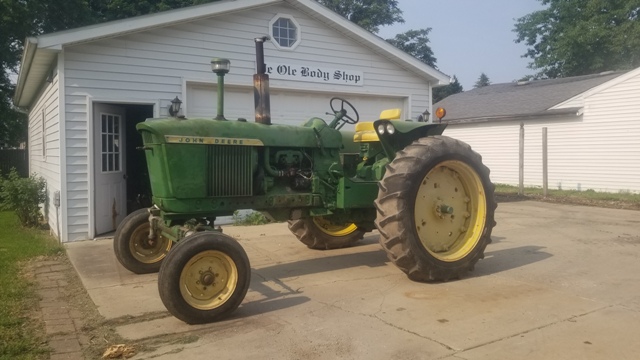

Now fully satisfied with the progress and turnout, I took her around town for about an hour filling the tank and fully up, and downshifting at all engine speeds. City cops waved at me probably thinking, "Damn, he riding another tractor"!!
And behind my house to look pretty for a spell. I'll stretch the new rear rubber onto it tomorrow most likely. Son in law has a couple of clean plastic barrels I'll capture the ballast with as I have a pump for the task:
It's been a fun project, and I've enjoyed both the work, and the learning experience as have never done one of these. Profitable too which is what it's all about.
