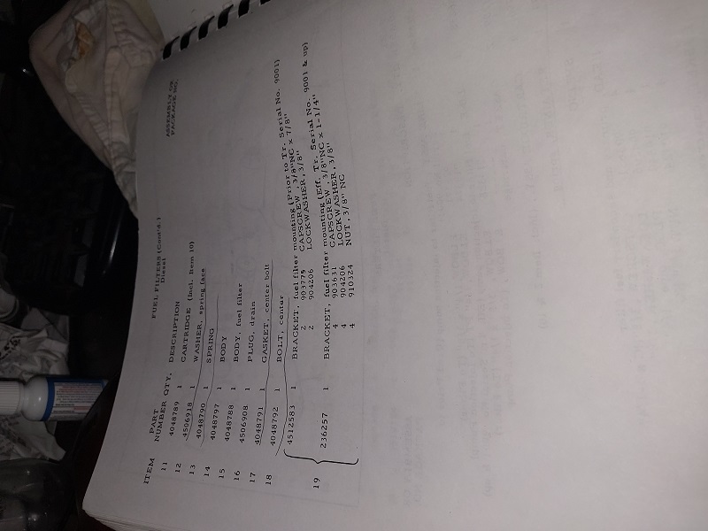

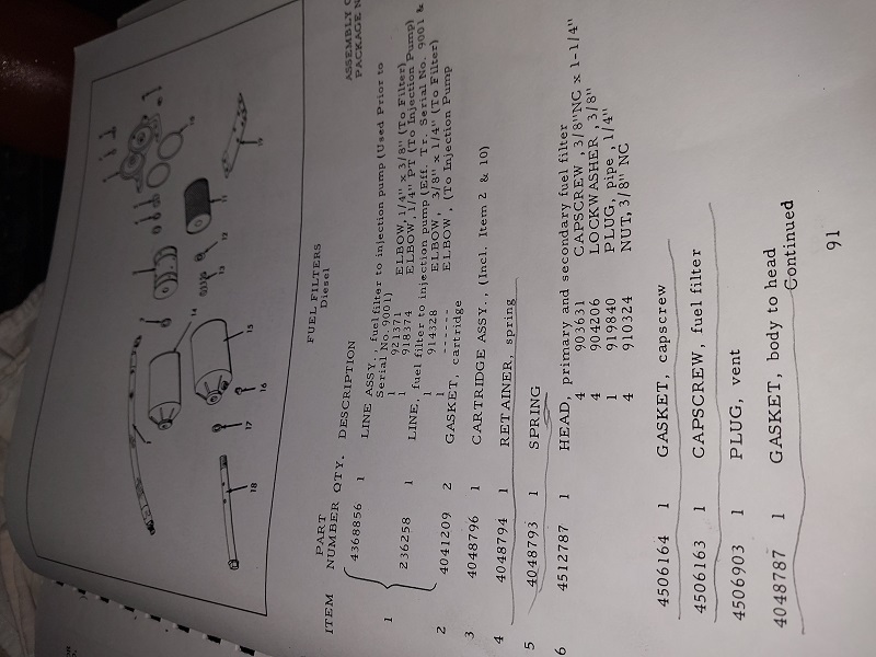

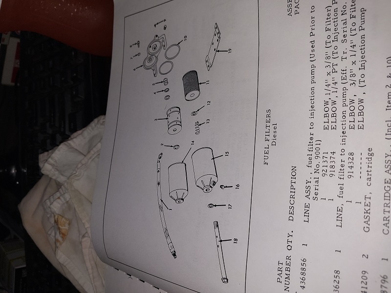

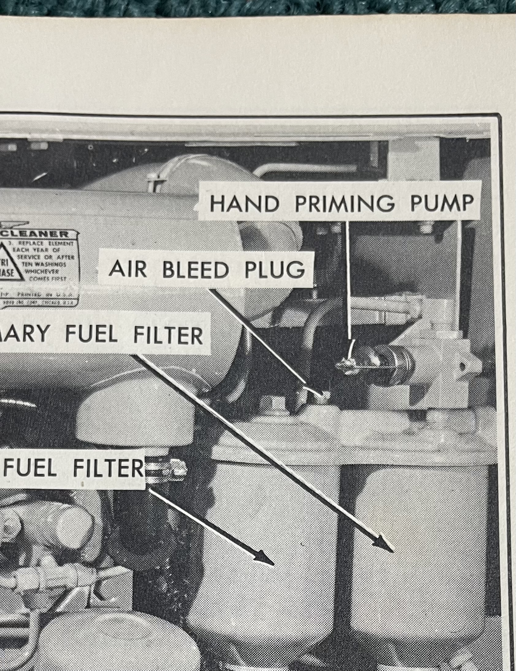

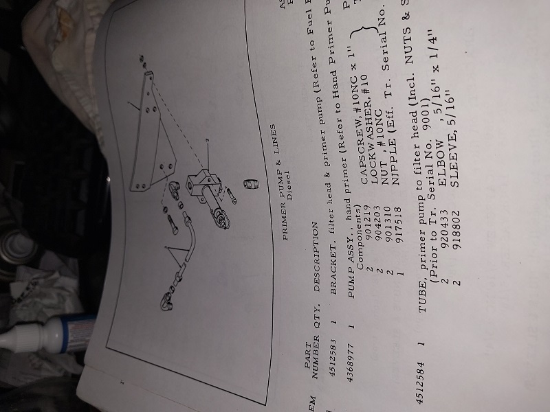

Here some pictures out of my D15 parts books which cover both I @ II.

Thanks Kenny. Once again, that's for a series 1.
I would prefer a picture of the correct set up on a Series 2 tractor. As mentioned earlier, none of the Allis publications have been useful in this case

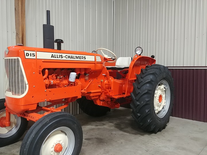

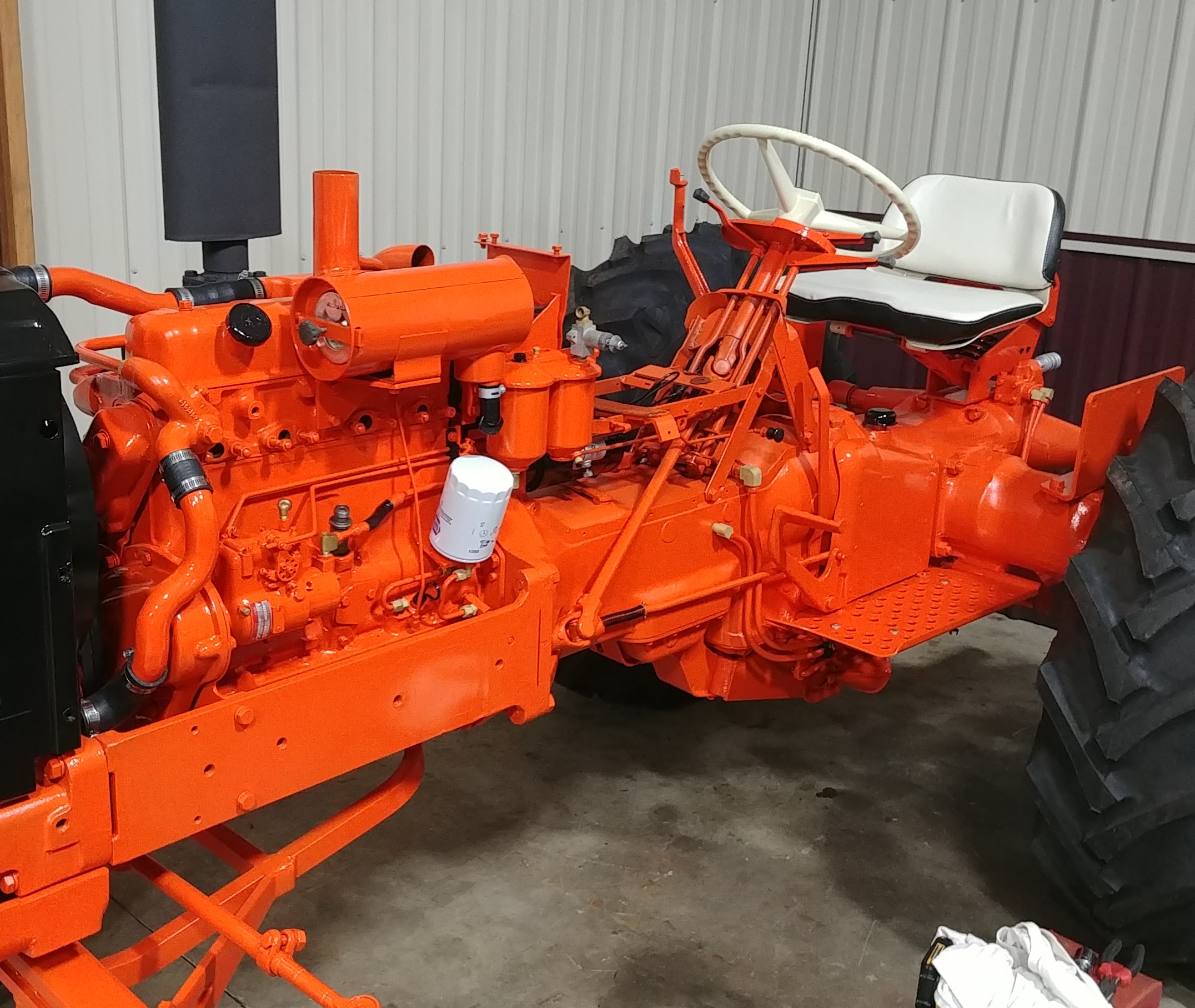

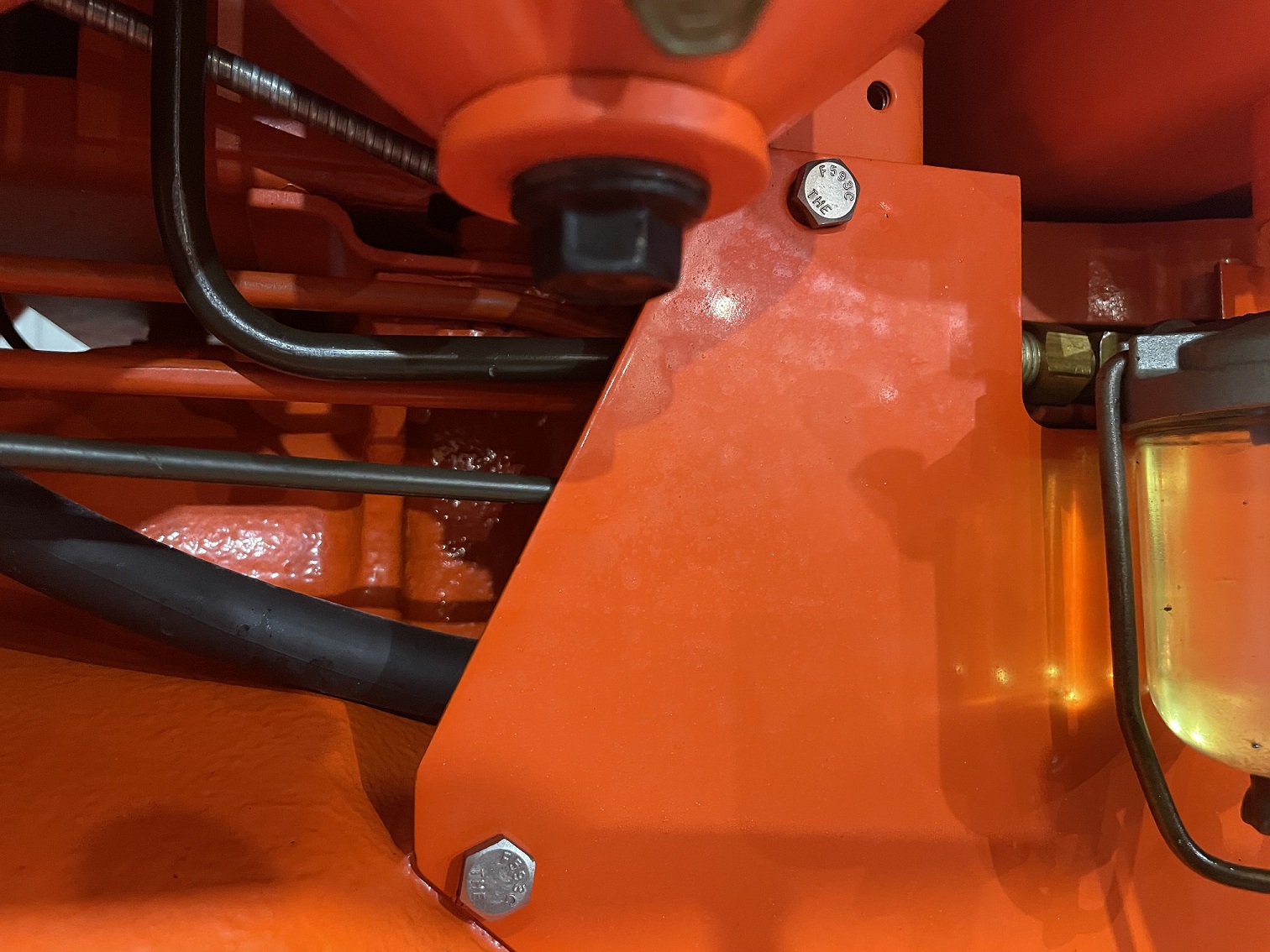

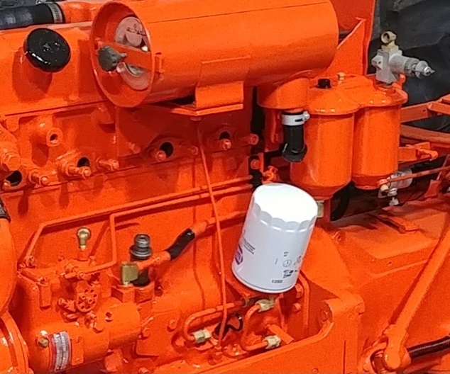

Sorry, not exactly what your looking for but it was the only pictures I have till I get home from work.
My hand pump sits on top of the filter housing and the steel lines runs down between the back side of fuel filter housing and the battery tray, goes behind the left side tank panel and into the bowl on the fuel tank.
To the best of my understanding this the the factory set up..
I can get you more pictures if you like.

Thanks Dan, that's great help. If you could get some pictures of the line going in the hand pump, it would be even better.
I gotta see if I can find a hand pump that will fit there.
That tractor looks great too!

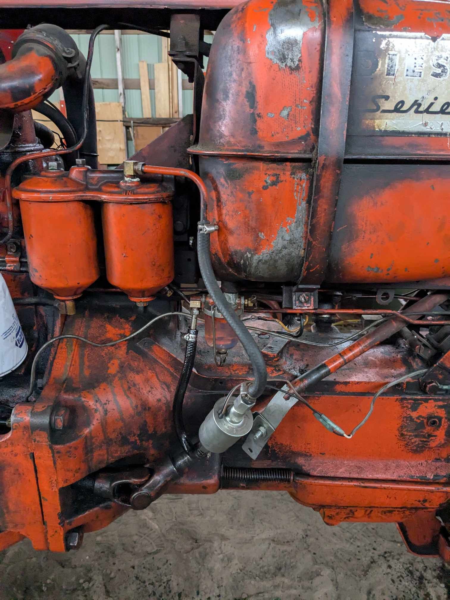

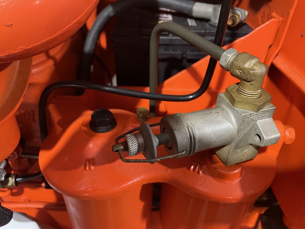

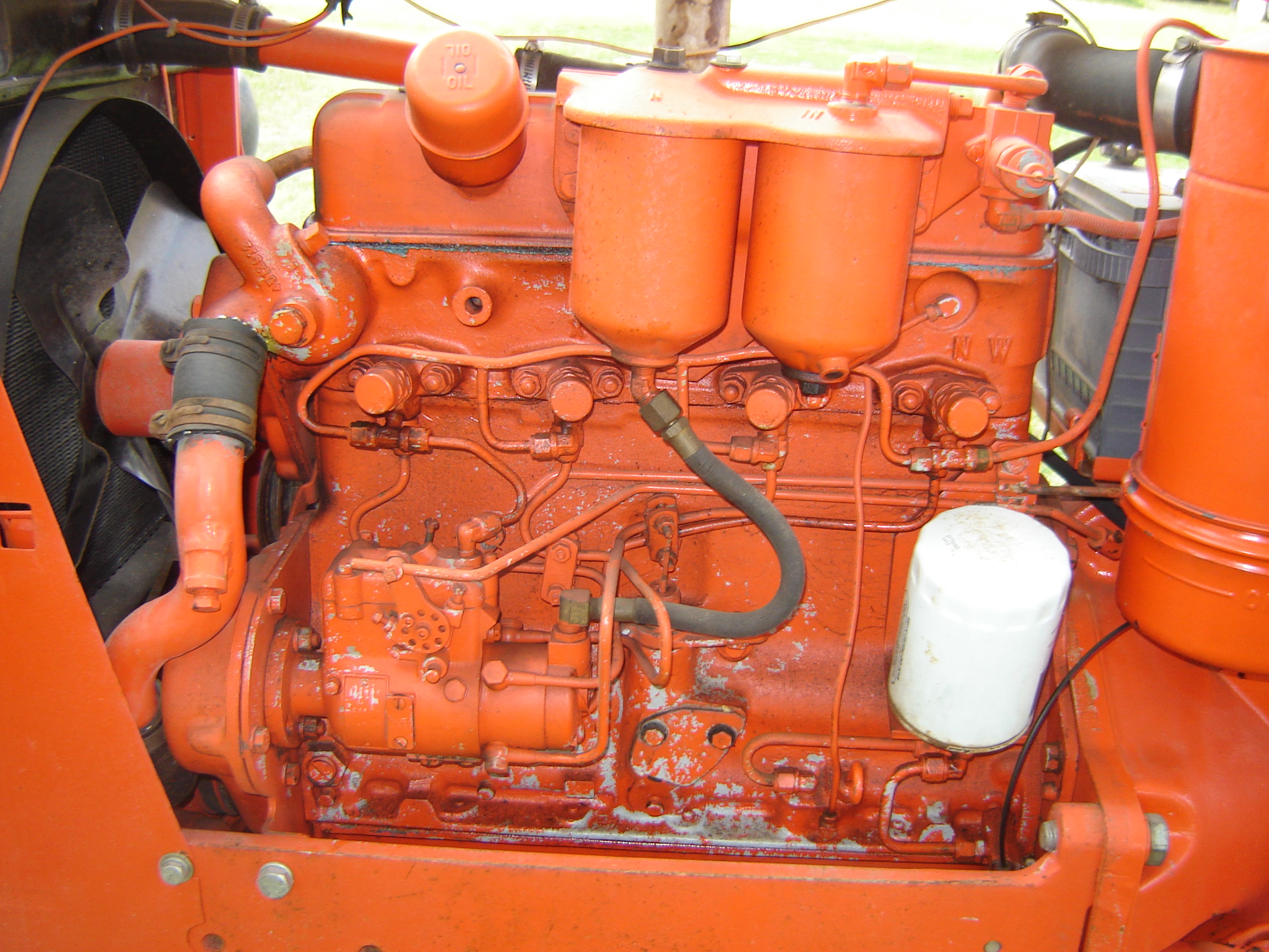

That is perfect!  Thanks very much!
