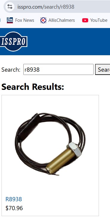

Need help finding part number for the magnetic sensor that screws into the adaptor plate for the tach. I got a 70264758 but it is to short. The tractor is an 8030 FWA serial # F2263

https://www.allischalmers.com/forum/8000-series-aftermarket-tach-sensor_topic32225.html
Points: 90643
Post Options Post Options   Thanks (0) Thanks(0)   Quote steve(ill) Quote  Post ReplyReply Direct Link To This Post Posted: 31 Mar 2025 at 8:00pm
discussion about sensor...............

Thanks for the info. I ordered one hope it works

Just wanted to report back that I got the new sender and installed it now tach works as it should. Thanks for the info
