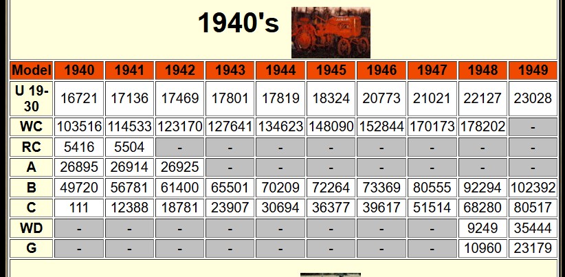

B 93884 is the serial number the number isn't on the chart can someone tell me the actual year and not send me the chart
Points: 90645
Post Options Post Options   Thanks (0) Thanks(0)   Quote steve(ill) Quote  Post ReplyReply Direct Link To This Post Posted: 25 Mar 2025 at 12:26pm
the LAST tractor built in 1948 was 92xxx... and the LAST tractor built in 1949 was 102xxx..
so yours would be a 1949..
